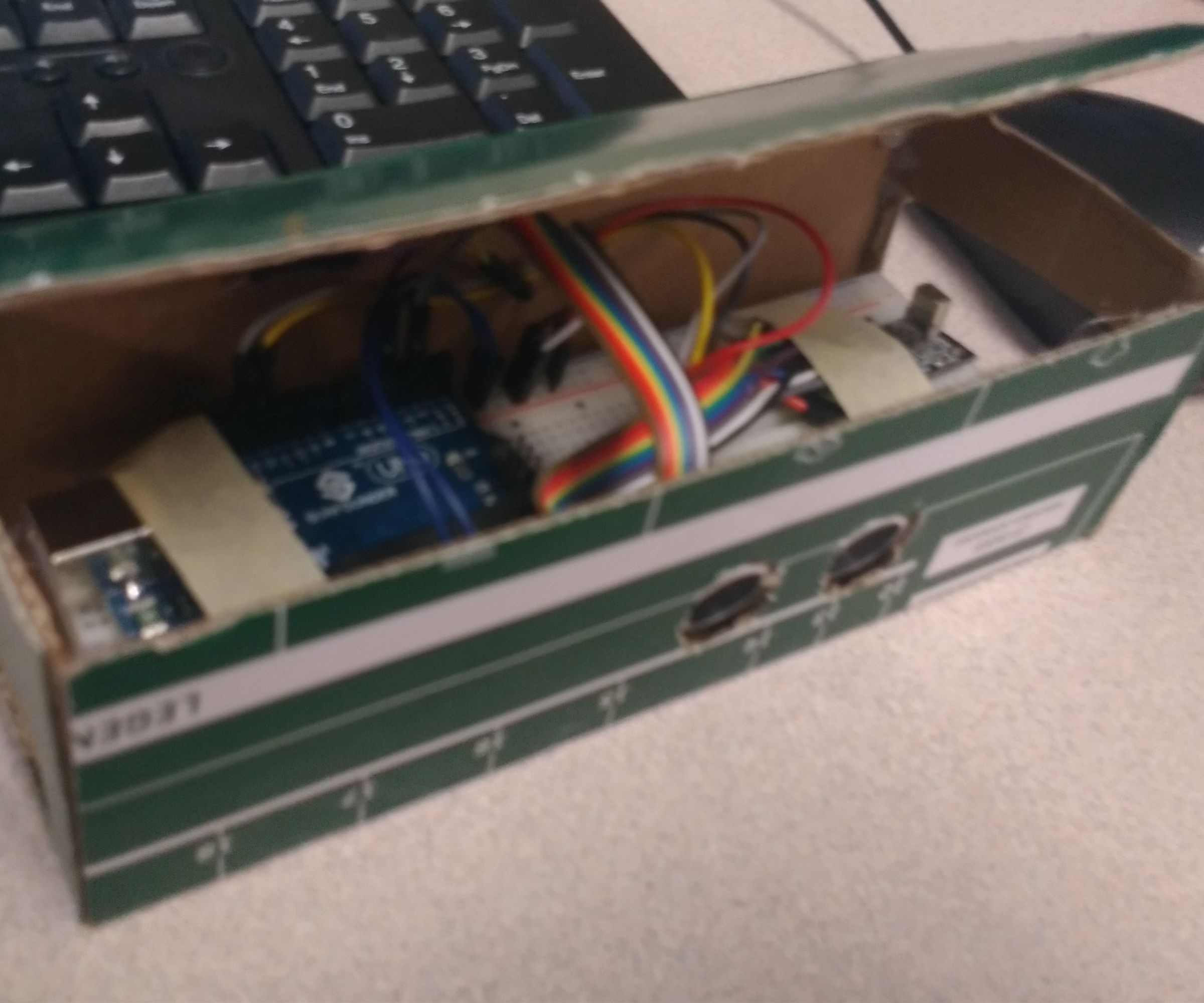

Step 2: Hocking Up the Survo
so a server has three wires attached to it each being a different color (white red black) each pin has its own purpose. the wight wire will be hooked up to the pin. the red wire will go to power. the black wire will go to grown. now with the bread bore hook it up some wires to the arduino being the positive and ground wires to the rails on the bread bored. now hook up the red and black wires to there corresponding rails. then put the white pin into the pin that will be running your servo.
Step 3: Hooking Up the Ultrasonic Sensor
the ultrasonic sensor has 4 mins to it vcc which is the power pin, there is the Gnd which is ground, trig , and echo. so to start connect some wires to the 4 pins then hook up the power to the positive rail on the bread bored and the ground to the ground rail. then plug the echo and trig pins in to the pin that where set to in this case 7 is echo and 6 is trig.

part 9: then in the rectangular piece of the base cut out a hole to fit the ultrasonic censer
Step 14:
part 10: then put aduino in and close it in a fation that makes the ultrasonic censer fit in the cut out and the servo is in the center connecting to the inner paper towel role
