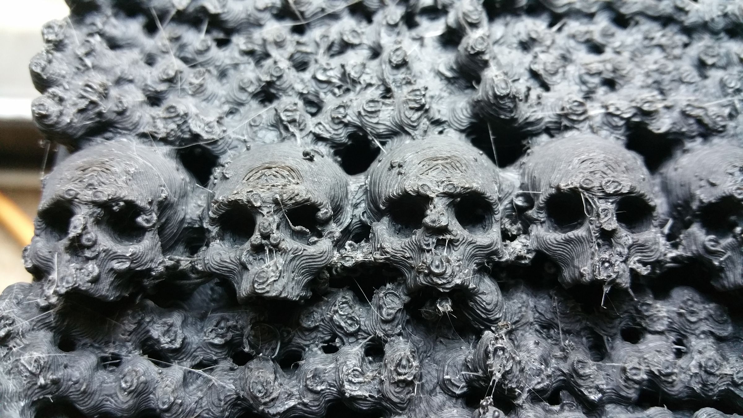

The outer wall is a grid of femur bone ends with cat skulls. Because I had so many print failures in the beginning, I modularized the wall into small panels. This way if there is a failure with a 6-hour panel, i've only wasted at most 6 hours versus 36 or 72 hours.
A panel is comprised of 3 rows of one bone end sitting below 4 rows of another bone end which is then below a single cat skull. It would have been better to have a bigger panel so that a pattern wasn't apparent, but I was afraid of risking print failures and wasted time. Interestingly enough, as I was printing and tweaking the skull, I realized that I came up with 3 distinct panels where the skulls differed. I guess if I was so inclined, I could have tweaked the bones to have a bit more randomness. Anyhow, I don't really think Jewel will notice or get fussy about the pattern.
Each panel has something distinctive about it. Wall panel 10 has holes in the skull giving access to the cavity inside the skull. This makes it possible to remove the inside support material giving it a little bit of authentic look. Wall panel 12 is the standard plain appearance. Finally wall panel 15 has a larger cat skull like maybe for a Maine Coon.

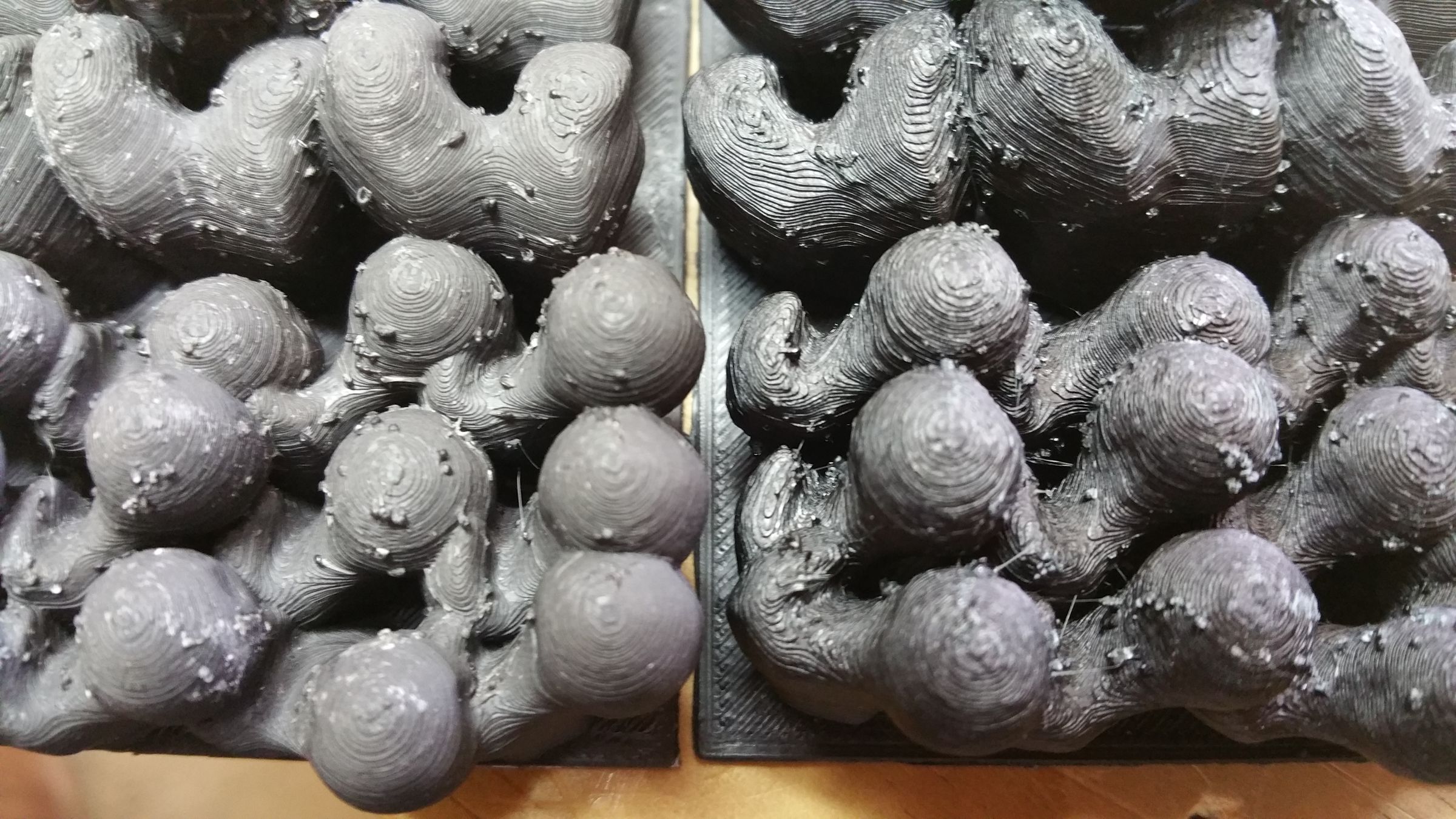

The inner wall comb is basically a grid of cones with tiny balls at the tip of each cone. At first I just had cones without the balls but it turned out to be too sharp. Adding the balls seem to help just a little bit. The panel size is much bigger than the outer wall panels. They are designed in such a way where 6 outer wall panels can mate back to back with 2 inner wall panels. When they are all glued together it will provide a nice rigid side wall.
As the pictures show, there is a lot of stringing. This means there is a lot of clean up.

After being grateful that the print completed, all of the strings and dots need to be removed.

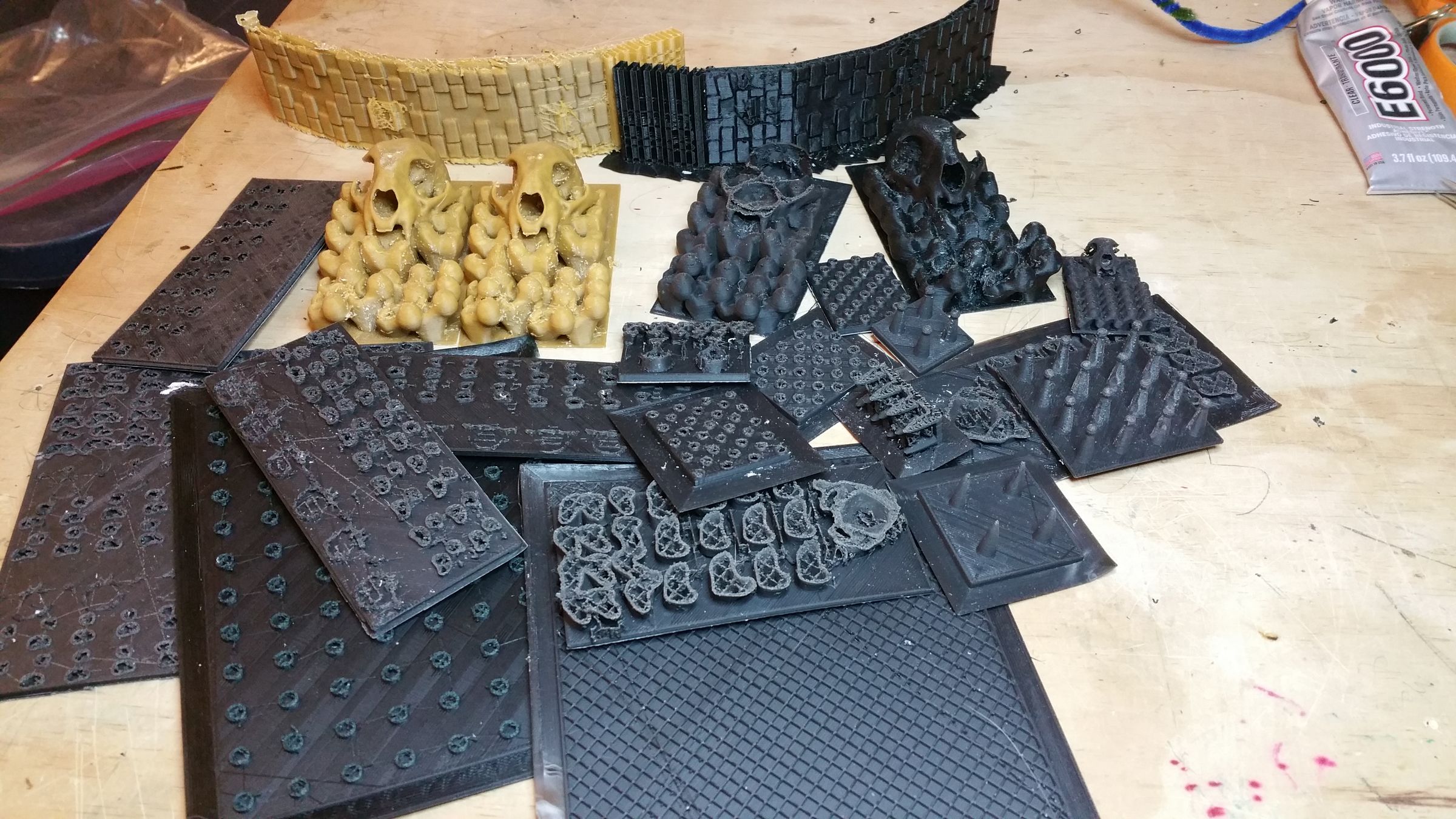

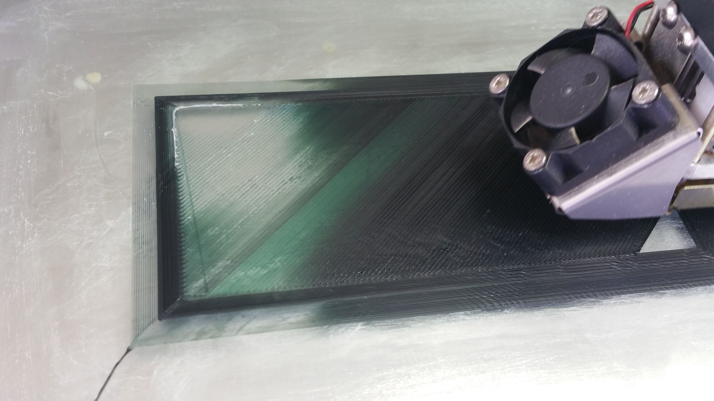

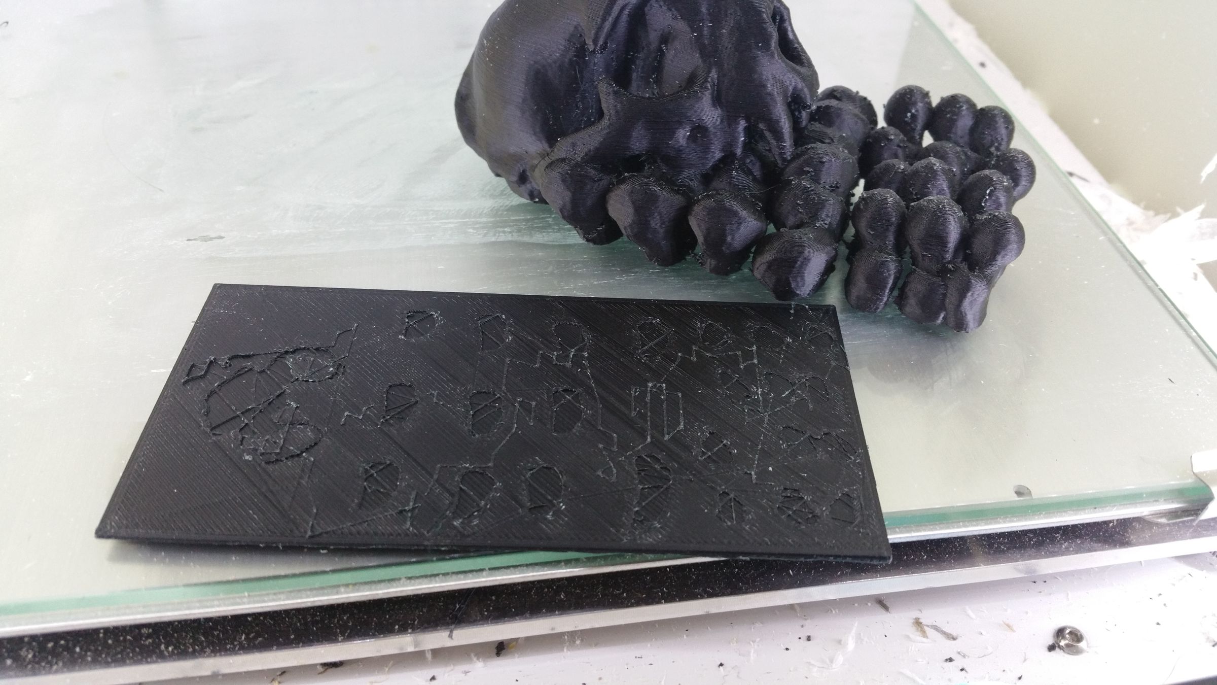

![]() | When I created my first 3D print, I tried to make it look like the Catacombs of Paris. Of course it took my daughter to tell me that I was using the wrong skulls. Back to the drawing board. |
This is what happens when there's a 0.5mm gap between the objects. They appear to be connected but in reality they're not. | ![]() |
![]() | One manufacturer's black is not the same as another manufacturer's black. |
The bed is just a tad higher on the (back) left than on the right. | ![]() |
![]() | Finally, all the failed prints and a few test prints. |
