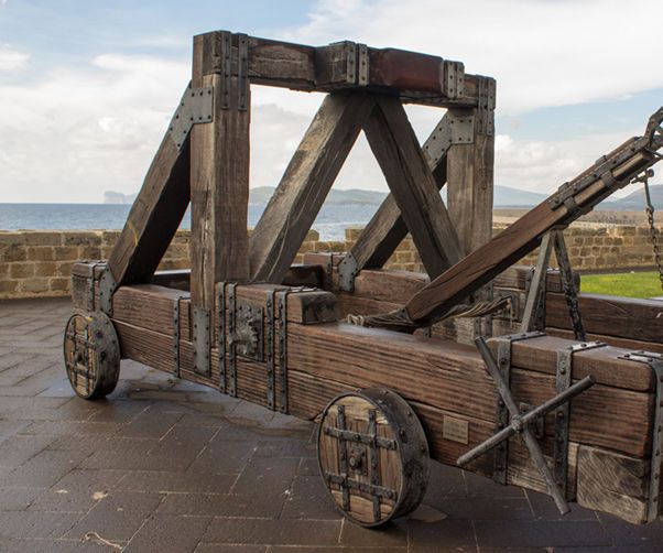

Step 3: Design
When we first got assigned this project we had a lot of research to do before designing our Trebuchet and Catapults. We did not have a lot of time so we had to work quickly. We had to build a Catapult and Trebuchet because of our group size so this shortened our time even more. After looking at many designs from other builders we have decided on the two designs above.
We were given some limitations, so we took those into account and tried to create the best constructions we were able to. Our pivot height was set at 48" or 4' and 8' arm with the pivot placed in our chosen spot. Our base consisted of 2 36" 2x4's and 2 28" 2x4's.
For our designs we used SolidWorks to create it.
