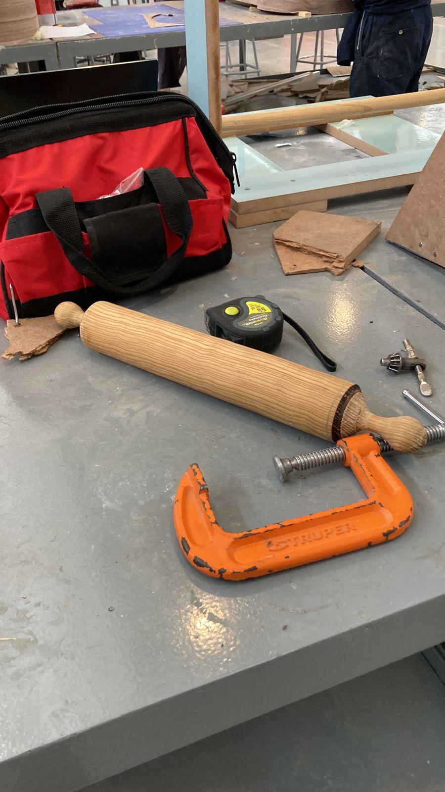

For this project, we will use MDF wood, strong adhesive of your choice, a rope, hammer, hacksaw or metal saw, wood nails, number 4 C-clamp,a drill and a bit the size of our nails or smaller, to make the holes where the nails will go, this with the objectibe of the nails going in more easily, we will also use measuring tape and 3D filament. Here is the list of materials: 4 wooden boards measuring 50 cm long x 14.5 cm wide and 18 mm thick, 4 additional boards measuring 50 cm long x 12.5 cm wide and 18 mm thick, one board that will serve as the catapult arm measuring 50 cm long x 6 cm wide and 18 mm thick, and finally, we will use a rods with the diameter of your choice, in this case, I will use 2 oak wood rods. We will also use 3D-printed parts that we will design later.

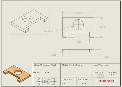

Step 5: 3D-printed Parts
Next, we will show images of two 3D-printed pieces we made. These pieces serve different functions, named Piece 1 and Piece 2. Piece 1 supports the ball we will launch, while Piece 2 is a handle that attaches to the catapult arm and the supporting stick. Images of the blueprints for both pieces are provided for your reference in creating them, along with assembly photos showing how the pieces fit together. A brief description includes the most critical measurements.
The support of Piece 1 is adjustable depending on the objects you intend to launch. This piece must also have a slot where the catapult arm will fit, with dimensions of 6 cm in width and 18 mm in thickness. Piece 2 will have a cylinder where the supporting stick for the catapult arm will fit. In our case, the interior diameter of the cylinder is 37.60 mm. Similarly, the piece should have a slot where the catapult arm will fit.
The rest of the measurements are flexible, as well as the type of filament and infill used for the 3D printing.

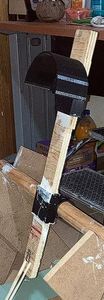

Step 6: Tension and Release Mechanisms
Once we have the printed parts, as we saw earlier, they need to be glued to the catapult arm using strong adhesive. We will attach these pieces to the catapult arm exactly as shown in the 3D assembly. After the glue has dried, we will add two nails to the underside of the arm. These nails are intended to hold the rubber bands that will power our catapult. Similarly, we will place another nail on the bottom base of the catapult to secure these rubber bands.
For the tension mechanism, we will use the other wooden stick we have and small portions of MDF wood. First, we will make the bases for the tension mechanism using MDF. Plans for the bases of the mechanism are shown, and we can cut them in wood or print them in 3D, The bases will be placed as shown in the photo, behind the arm of the catapult.
Once we have the bases ready and in place, we will proceed to make a hole in the wooden stick. The diameter of the hole depends on the thickness of the rope we will use for the tension mechanism. Once we made the hole, we will pass the rope through it and tie a knot on the other side to secure it. Then, we will tie the other end of the rope around the stick to be able to tension it. The excess rope will be passed over the arm of the catapult, above the handle for the ball as shown in the pictures.

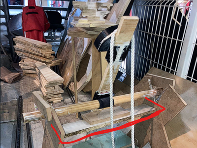

Step 7: Final Details
We now have the tension mechanism and the rubber bands in place for the power of the catapult. As final details, we added three different stops to the catapult to solve various problems. The first stop is a wooden board 50 cm long and 12 cm wide, placed transversely at the bottom of the catapult arm, as shown in the image. This stop is intended to prevent the catapult arm from throwing the ball downward due to the tension of the rubber bands.
The other two stops were nailed to the top of the bases in an 'x' shape, using leftover MDF wood that we had. The purpose of these stops is to prevent the catapult arm from moving out of position due to the tension released by the rubber bands when the catapult is activated. All these adaptations are optional and not necessary unless you encounter the same problems as we did when building the catapult.
Finally, we reinforced all the bases of the catapult by adding more nails to give the catapult more stability. The catapult is finished, and it just needs to be tested!
