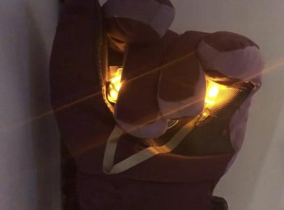

This is a simple series circuit applied onto a glove.

Step 1: 1. Layout
I began the project by making a blueprint to assure that the LEDs are placed correctly and then transferred the drawing onto the glove.
Step 2: 2. Conductive Tape
Following the blueprint, lay out the conductive tape onto the glove. Leave gaps where the LEDs will appear. In this model, the LEDs are on the side of the palm, so that the light can be seen through the gaps of the hand.
Step 3: 3. Attach LEDs
Attach LEDs. This can be done by soldering onto the conductive tape or by attaching it with electrical tape. Please note that electrical tape will make it more prone to falling off.
Note: in this project that the Negative end of the left LED is distal to the wrist. And the Positive end of the Left LED is proximal to the wrist. The Right LED has the Negative end of the LED proximal to the thumb and the Positive end of the Right LED is distal to the thumb.
Step 4: 4. Prepare Heat Shrink Tubing
Cut holes in heat shrink tubing. This allows the tape to touch the batteries, while the batteries are attached onto the glove.
Step 5: 5. Attach Heat Shrink Tubing
Using the heat from the soldering iron, add heat shrink tubing over the batteries.
Step 6: 6. Attach Battery
Attach the battery onto the circuit. This can be done with hot glue or electrical tape. We want the positive end of the two 3v cell batteries to touch the end of the conductive tape on end by the LED. The negative side of the battery will touch the end of the conductive tape that starts at the finger.
Step 7: 7. Open and Close Hand
Open and close your hand. The finger with the conductive tape should fall above the negative end of the battery. The LEDs will light up. The lights can be seen from the sides of the palm.
