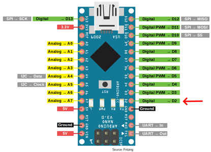

Using the wire connect. (directions are for Adruino Nano. Consult pinouts if using a different board)
  • White wire to Adruino pin A4.
  • Black wire to Adruino pin A5
  • Red wire to Adruino Power(5v)
  • Blue wire to Adruino Ground

Connect normally open push button to D2 and Ground. If you do not connect the switch you must upload CatgenieCartridgeEmulation-3.ino to Arduino.
