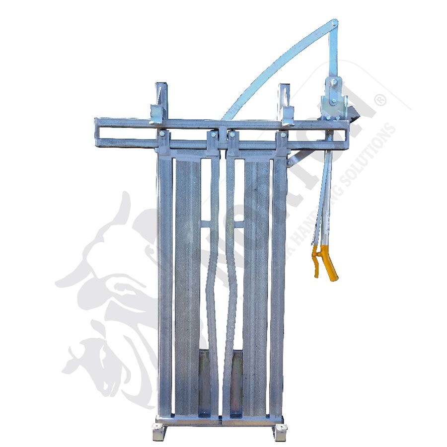

Step 5: Make the Head Bails
This is constructed from various sized steel bits as per the plan . It has an oil filled damper that locks the bail in place when closed and is releases when the hand lever is raised .
There is a second operating lever at the vet door end of the crush which can be locked in or left free.
The opening /closing mechanism is an aprox 600mm x 50mm x 8mm bar (see drawings )with a pivot in the center one end pulls in while the other pushes out. It is slightly complicated with some slack so a plunger on the oil damper will operate to allow the bails to open when you want them to and not before.
There is a locker handle assembly near the head-bail with a drilled hole in the end which goes on a large bolt installed in the Angle piece support . It faces backwards and the 40mm x 40mm piece goes in and runs to the side of the vet gates . There is bolted on the top of the carcass another handle assembly with a piece of 50mm x 50 mm with hole and bolt again facing to the front which slips over the 40 mm x 40 mm extension bar. You can fully weld on the rear support but it means you must remove or drop forward the head-bail to release the 40 x 40 mm rail. See pictures and drawing only atm
The head bails are secured to the carcass by 8 tangs of 100 mm x 50 mm x 6mm bar with holes drilled for bolts outside see pics
Weld 4 on the carcass and 4 on the head-bail. Bolt together in twos and fit headbail up to carcass and clamp with tangs between then do the diagonally opposite side ,clamp then fit the other two and clamp and use a hammer to adjust the positions of the headbail then . when it all looks OK tack weld them , undo bolts and then fully weld the tangs.
Make up Baulk gates as per drawing and attach to outside tangs. These are running up and down to reduce the risk of you being hurt if a cow doesn't like what you are doing. You leave the head bales open and the baulk gates closed to get them to put their head up front .

    These look great! How well do they work in situ? You mentioned in the head bail section that you were working on a head restraint system. Have you considered a slightly diamond shaped gate to restrain the head?
    0
    tytower
    tytower
    Reply 3 years ago
    Y'know at this time its had 8.4K views and only one comment so I mean it when I say "Thanks for the comment"
    I have two of these in use and both work great. I did not work out a head restraint that would not interfere with the open close of the above pipe system so Ill study your suggestion . Another approach to the head bales might well be the way to go . I considered welding small bent pipes onto the main restraint poles two above and two below , but I decided against it as I have small calves going through too and the bottom ones would catch them badly round the kneck and risk breaking their kneck. Perhaps another set above for the bigger ones might work.
    Cheers

    That looks like it would be quite good . I have 1200 Kilo droughtmaster bulls and I look at the side support there but the spacing of the top rail over the outside rollers would need to be thick wall square tube I think and that would handle the forces . Yes i will try to build that when one of them rusts a bit or I have a use for the round pipes elsewhere . The beauty of galvanised tube is it lasts much longer and with an occasional cleanup acid kill and paint of the weld joints only , its holding up pretty well after 3 years.
