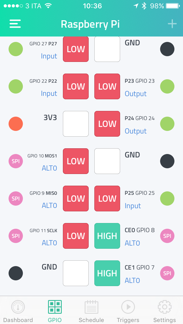

You can personalize the Dashboard of Cayenne by using the widgets. The default Dashboard have CPU, Temp and RAM widget . These are the values of your Raspberry Pi. You can see the temp and the work flow of Raspberry pi. Then you can see the GPIO schedule. In the GPIO you can set every pin of GPIO of Raspberry. You can set the pin like Output or Input.
Then you can activate the pin or read the value of the pin. The two values are HIGH or LOW. This is valid for Input and Output.

Now go to the Dashboard of Cayenne, and open the GPIO schedule.
Then Select the Pin 17 and click on Input. Setup the pin like Output, and after click on LOW button. The button below Green and the word HIGH appear on it. Now your led in ON!

On The Cayenne GPIO schedule, you can set like Output the pins number 25, 24 and the pin number 23. After this you can switch on each one of this leds, or mix these colors.
