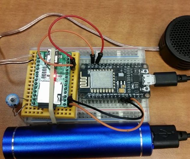

This project uses the Arduino Uno with a Wifi101 shield, an NPN switching transistor, resistor, and IR LED. It also needs a sacrificial USB cable, a portable power source, and fake plant, etc. to hide it all in.
I used a PN4275 NPN BJT transistor, but any small signal switcher will do. The PN2222A has the same pinout.
https://www.fairchildsemi.com/datasheets/PN/PN2222...
Emitter goes to ground. Base goes to pin 3 through a 1 or 2k resistor. I used a 2.2k. Collector goes to the short side of an IR LED (Cathode). Anode goes to 3.3V.
If your trying to fit into a small case, you can cut up a USB cable and get the usual Red and Black lines for supplying 5V to the rail instead of at the connector. I always save the Apple cords for this. Cathartic.
