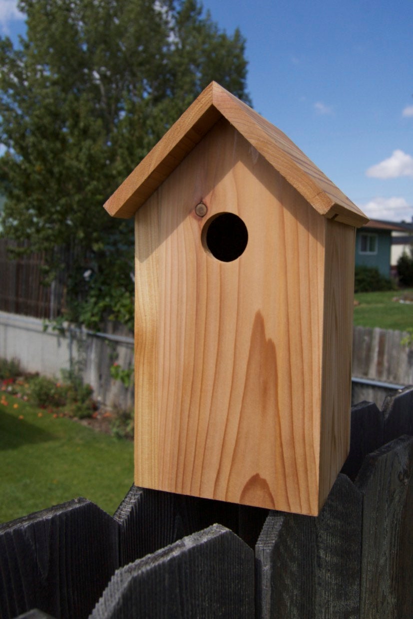

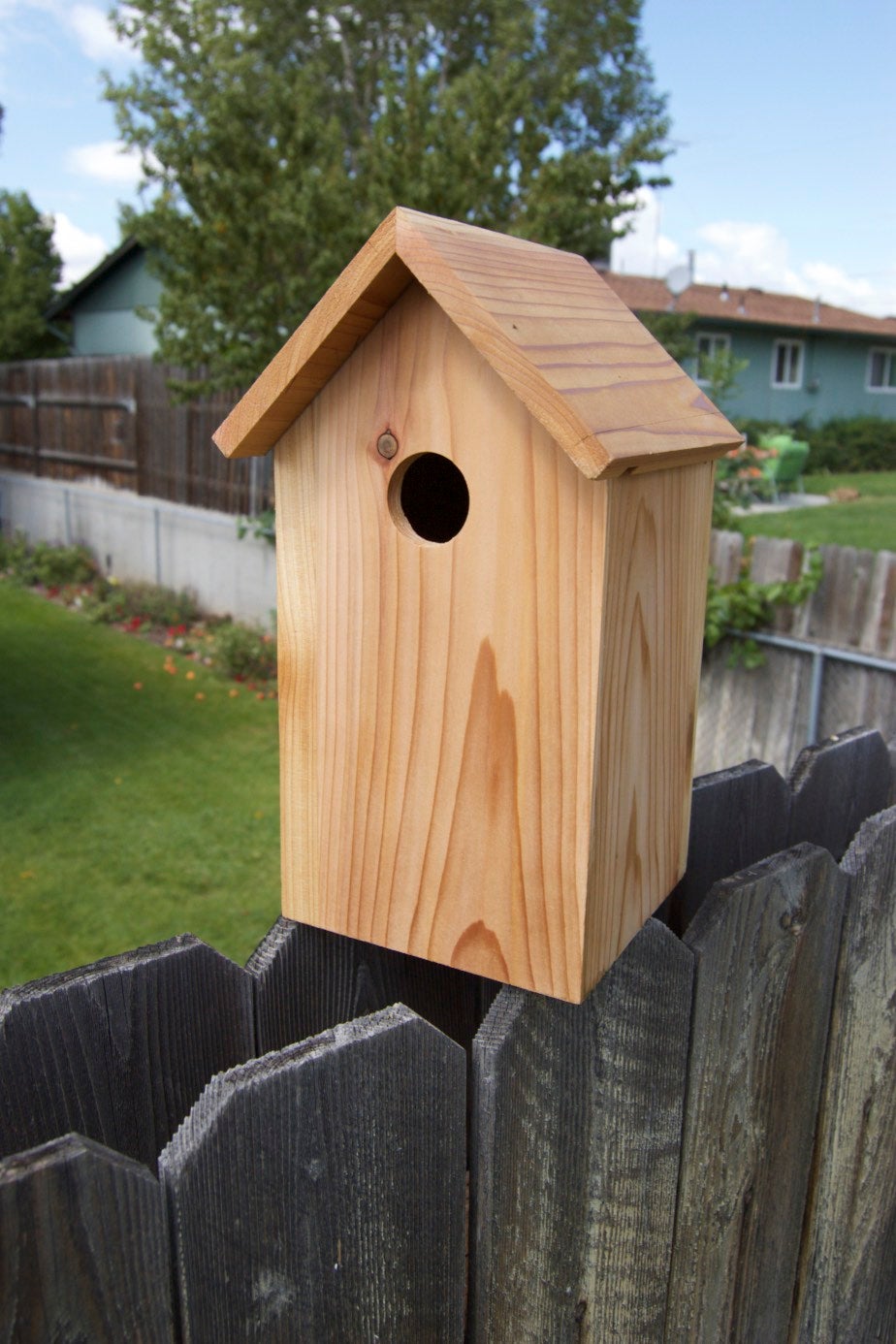

Introduction: Cedar Blue-Bird Birdhouse
My son enjoys watching birds eat out of the bird feeder and he became concerned about their living arrangements. He promptly requested that we build a birdhouse. We originally tried to find one on Amazon to just assemble together but we couldn't find one that we liked and it turns out most of them wouldn't be suitable for actual birds anyway. A little research found a bird watching website that has information about the specific size of bird houses for different birds.
The bluebird likes their floor size to be 5" X 5", Height to be between 8" - 12", Entrance above floor 6" - 10", Hole diameter 1 1/2" - 1 9/16", and off the ground 4' - 6'. They also don't like those cute little perches because it makes it easier for predators to get in.

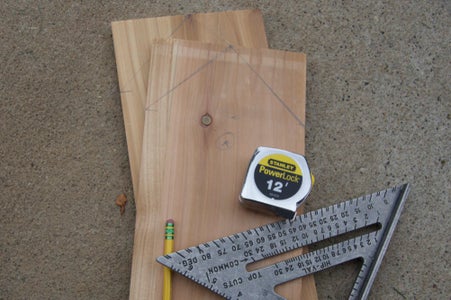

Start by ripping all the parts to width. Then using the miter-gauge cut the pieces to length. I recommend labeling all the parts at this point. It is a good habit to have when working on larger projects. Next cut the slope on the front and back pieces. To find this I marked 3" to the middle and 3" down from the top. While marking out those cuts I also marked the hole on the front piece at 3" and 8".

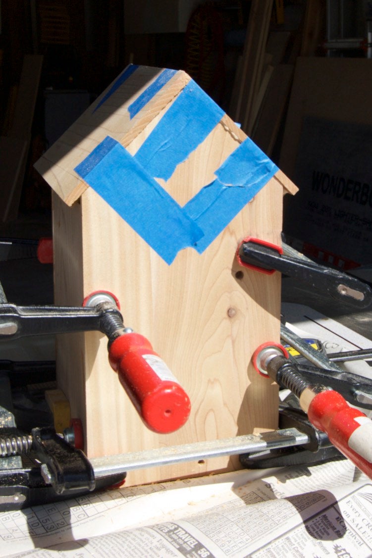

Step 4: Assemble
First you'll want to dry fit all your pieces. You don't want any surprises when you've got glue drying. Set out your Automaxx clamps so they are ready to go.
Put glue in the dados on the sides, front, and back. I put the the side pieces together with the bottom first and clamped that lightly. They are all the same size so the edges line up at the bottom making the back and front pieces easy to place. Place clamps so that there is even pressure on all the joints. Check for square. Dry fit the top pieces, if they fit it should be close enough for any bluebird.
The top pieces will be held by tape. I used painters tape on accident and it worked but there is tape for this like 3M's binding tape. I lined up one top piece with the top of the roof. Applied the tape to the top of the roof created tension in the tape and tacked the tape down on the back piece. Then with the other top piece I applied tension across the mitered edge to bring the two roof pieces together. Last I put a piece of tape down the back.

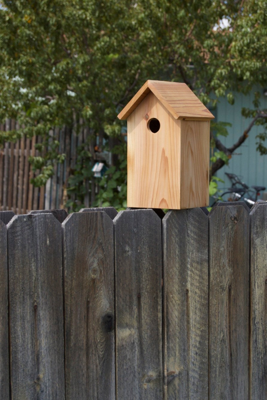

I finished it with a coat of Deft spray can clear finish.
