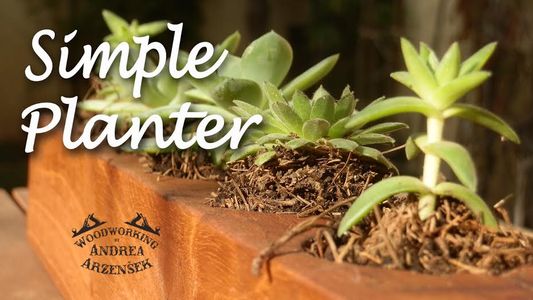

Introduction: Cedar Succulent Planter
About: I'm a passionate maker and video creator on YouTube!
Make this lovely succulent planter out of 3x3 cedar plank.

Step 7: Plant It!
Use any type of plants to plant your planter (that is a lot of word plant in one sentence).
I like succulents because they are very resistant plants and don't need much water (good for the wood) and confess it, they look beautiful.
