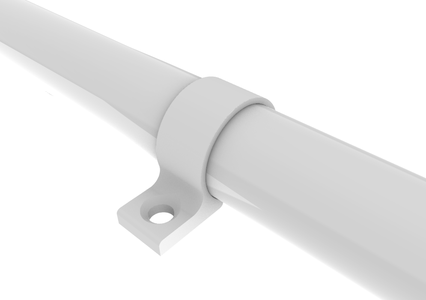

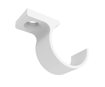

If your branches hang down from the ceiling and it bothers you enough you can print these clips that wrap around the tube and then you'll have to screw them to the ceiling. Use at least one per branch probably.
I don't mind the arms hanging cause it casts interesting shadows
