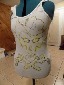

Once you have your clothing you will want to block in where you want the shadow/highlights to fall. I placed my clothing on a dress form but a mannquin or even a person (who is willing to put up with being painted on) OR some newspaper to fill in the clothing would suffice. Any way to give the clothing form is wonderful just DON'T paint it flat. Why? You lose the effect of natural shadow/highlight and it can look strange when worn.
Once you have your clothing setup it's time to take a sharpie or fabric pen or normal ink pen and draw in where you would like to paint. I followed the natural curve of the clothing and exaggerated where the wrinkles were for more defined effect.
If you have a custom design (like the skull above) you can do one of two things: draw it on your clothing with a fabric marker (or a pen if you're confident) OR you can print it to size and trace it onto the clothing. I drew on the design for Nisha as I have a background in illustration and animation but NEVER be ashamed to trace a design to ensure it's accuracy (cloth painting is tricky enough).

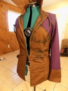

With your medium and paint mixed begin applying the base color. For Nisha's shirt that was the purple and for her jacket that was a dark gray (between where I blocked the shadow and highlights). Once your base is on give it an hour to dry. If the color is what you like after an hour then it is safe to proceed. If it's still wet please allow more time to dry before moving forward with shading.
When you are ready to shade start with the darkest hues first. As I mentioned, the fabric medium lightens things so it is MUCH easier to go lighter than darker. Block in your shadows then allow them to dry (1 - 2 hours). If you do not have time for it to dry you may use a hair dryer (on its lowest setting ) to expedite the process.
With the shadows in place you may now proceed with the highlights. I suggest adding just a little extra Fabric Painting Medium to the highlights and REALLY punch UP your highlights as they have a chance to fade in the next step.
