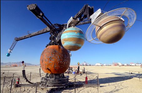

Celestial Mechanica is a 16-ft tall kinetic steel sculpture of our solar system representing the majestic dance of the heavenly bodies. It was created by a team led by Jessika Welz for Burning Man 2014.
(Project facebook page: https://www.facebook.com/celestialmechanica2014)
The 4 gas giant planets, Saturn, Jupiter, Uranus, and Neptune are
cantilevered out on steel arms, the longest arm being about 20 feet. The arms rotate around and are driven by the gearbox that this Instructable talks about. The 4 rocky planets, Mercury, Venus, Earth, and Mars, are mounted on 6' diameter ring gears around the base that are also driven by the gearbox.

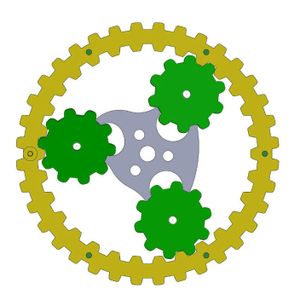

Controlling speed by releasing the drive force and letting things slow down one little bit at a time seemed the most practical way forward- the torque would be significant and the motor would be running at a constant speed, so it seems easier to let the torque slip a little bit at a time than to have some mechanism to add torque a little bit at a time. I ended up going with a planetary gearset, where the cage that holds the planet gears would be held fixed by a solenoid-actuated brake, the ring gear would be driven by the motor, and the sun gear would drive the planet. There would be 8 of these in a chain, the speed of each step in the chain being from the previous one by the gear drive ratios. In this way, we could get the wide range of speeds we need without the jump in gear ratios being too big at any one point.
The speed of each planet would be controlled by the brake on the cage of each planetary gear. For the planet to go full speed, the brake would be applied fully, which would transmit all power to the planet. To slow the planet down, the brake would release, and friction would slow the orbit down. A helpful illustration of the principle is in the first video. There would be a microcontroller constantly applying and releasing the brake to achieve the desired speed- it would be a sort of really slow, mechanical pulse width modulation. The micro would also sense if wind was speeding up the planet when the brake was released instead of slowing it down, compensate for that, and use that to keep track of the prevailing wind direction. That was the idea at least.

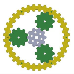

I assembled some of the planetary gearsets to see how they worked and went together. Reality is a pain sometimes: They did not work as smoothly as I had hoped, or indeed in a way that the brake speed control mechanism would work at all.
One problem is that the parts were cut using some cheap imitation plasma cutter consumables from alibaba that we had around. Never use cheap imitation plasma cutter consumables except maybe to prop up small parts for painting. Rough edges on gear teeth and holes that weren't quite round plagued many of the gears and became a real problem for the gearbox that still isn't quite gone after a few upgrade cycles. Furthermore, our CNC plasma cutter was suffering from a slipping coupling on one of the stepper motors. It was not bad enough to be noticed, but bad enough to make all of the gears slightly oval.
Another problem was with the design of the planetary gears. The ring gear is driven, the cage is held fixed, and the sun gear drives the planet orbit. This means that the speed gets increased by the planetary gear system, which means that problems with friction and imprecision get multiplied. Early on in the design, I went back and forth a few times on which parts of the planetary gearset were the driving, driven, and fixed ones. Each variation had some compromise or something that made it not doable at all, so at the time this design seemed like the best way forward. But looking back, increasing the speed in the planetary gearset was probably a bad idea.
I fiddled with the planetary gears for a few days, and it just didn't seem hopeful that they would work. The planetary gears were there for controlling the planet speeds only. With about a week to go before the piece shipped, we decided to let go of the idea of speed control for now. The planets would still orbit with the right proportions of speed to each other due to the ratios in the rest of the gearbox, but the planetary gearsets would be locked together. We substituted the sun gear in each planetary gearset with a "sun-not-gear", which locked into the teeth of the planetary gears and made the whole gearset rotate as one. We left the brakes, brake actuators, and microcontroller system off.

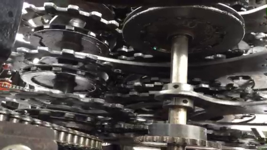

After we decided to forgo the operation of the planetary gears, assembly proceeded and went fairly well, though with lots of extra die-grinding due to the plasma cutting issues. One issue that came up was that the sun not-gears, which I had rushed through in designing since we only had a few days left, could not be assembled with all three planetary gears in place due to the angle of one of the "claws". But I figured that it would be OK to just leave one of the gears out, since everything would still be locked in place and was held in place by the gear cages. We connected it up and turned it on for the first time, and it worked! There was some kerchunking from areas that still needed to be ground down, but it was mostly pretty easy to fix. We got it running smoothly, and sent it off to the desert!

  • The gears in the gearbox were too free to move up and down. The whole gearbox is fairly loose and flexible, most of it is just locked in place by how it is assembled and has no bolts to fully constrain it. This is by design. There are a few different ways to approach precision, fit, and alignment in mechanisms. One way is to make everything very precisely, and constrain it in place tightly. In many cases such as high speed mechanisms, this is really the only way. But plasma cutting and welding finished parts together are not precise operations, so we have to make the mechanism be able to deal with it's inherent imprecision. To make something imprecise work, you have to build in adjustability and strategic flexibility, otherwise overconstrained parts will produce huge forces in unintended ways and break or jam. But we went too far at first in allowing the gears flexibility to move up and down, and they would jump out of alignment with each other. So we welded on additional 1/8" steel rings to the top and bottom of some gears. These ensure that the gear can't move up or down relative to the gear it meshes with.
  • I calculated out the spacing of everything in the gear stacks precisely and, in the original build, added shims to match those calculations. But reality just didn't jive with those calculations for reasons I'm still not quite sure of. So to get gears towards the top of the gearbox to align well in the vertical direction, the ones toward the bottom had to be pulled more out of alignment and vice-verse. The gears will tolerate some misalignment due to the aforementioned flexibility, but being misaligned makes them more likely to skip if there are other problems at play too. When I rebuilt the gearbox, I tossed the precise calculations aside, and just added shims to each level one at a time to make it mesh well with it's counterpart. It was more tedious than adding in a predetermined amount of shims, but the alignment of everything in the gearbox turned out much, much better.
