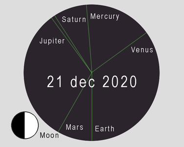

Step 13: Calibration
Calibration is key, and for this orrery, it's a breeze. Just refer to an online solar system for accuracy and make comparisons. Open the device and rotate the date so it is just about to start incrementing the year counter. Use the provided image as a reference for 21 December 2020 to set everything to the correct position before closing it again.
Given that these gears are made of wood, don't be surprised if it doesn't run as smoothly as you'd expect. Patience is the name of the game. If things get stuck, gently wiggle the moon phase pointer and perhaps nudge some of the planets to free them up. But when carefully constructed and some use of sanding paper it should run smoothly.
In this model, we've used the following orbital periods (with real values in brackets):
  1. Mercury: 0.2407 years (0.2408)
  2. Venus: 0.6154 years (0.6152)
  3. Earth: 1.000 year
  4. Mars: 1.880 years (1.881)
  5. Jupiter: 11.86 years (11.86)
  6. Saturn: 29.40 years (29.45)
  7. The time between two full moons: 29.531 days (29.531)
Note that only Saturn shows a significant difference with the expected value, but as it rotates very slowly, you will never have to re-calibrate your orrery ever again. It really is very precise. (but to be honest, you might want to re-calibrate Mercury and Venus after 10 years or so by skipping it by one tooth)
Here's a bonus feature: I've designed it in such a way that you can replace the sun's axle with a DIY battery-operated clock mechanism. Opt for one with a slightly longer shaft so that the clock hands gracefully glide over the planets and make a bigger hole in the back plate. However, in the end, I decided to keep it as-is and proudly hang it on my wall.
Calibration is the finishing touch to ensure your orrery reflects the celestial wonders accurately. Enjoy your handcrafted masterpiece!
