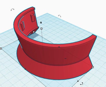

Step 2: Right Ascension Shroud
Whilst this is a simple part, getting the supports right can be tricky. By all means try automatic supports in your slicer, but I found that I got best results using custom supports at various points at the ends of and at a number of places around the smallest radius of the overhanging part, then a similar job on the top larger radius.
Material: PLA
Layer Height: I used 0.2m, but you might get away with 0.3mm
Supports: See above

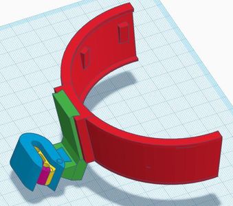

Step 3: Mount Cable Clamp
3D print out the parts you need, then poke the vertical pins through the holes in the T piece, aligning them so that the flats face each other and the D shape goes into the same shaped indentations in the bottom of the T piece. Force the two clips over the ends of each of the pins and all should be good.
Once the assembled clamp is attached to your CGX mount, the hole in the vertical part should go over the power connector and be held in place by the power cable's securing nut and the two pins should be a tight fit in the two bolt holes nearest to the power connector on the CGX mount. I remove this cable clamp when I finish an astrophotography session and pack my mount into the car, as it will break if the mount rolls over onto it.
Material: PLA
Layer Height: I would recommend 0.2mm or smaller as the parts need to be a precise fit
Supports: Use automatic supports for the overhanging part of the T piece and the hole in it
