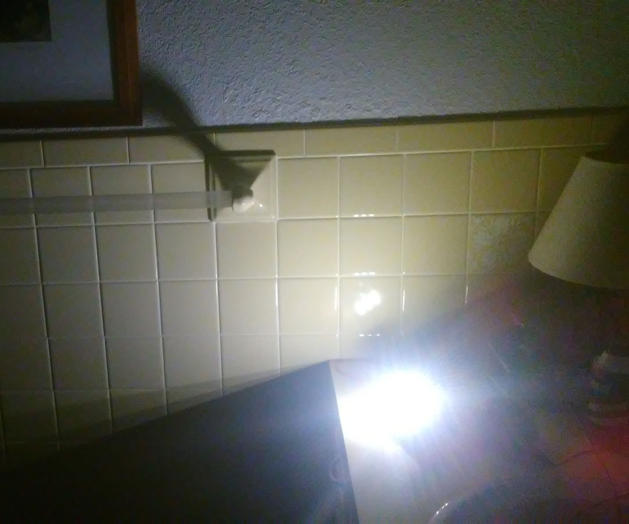

Now that your flashlight is complete and ready to go, have fun with it! I decided to take a couple measurements right off the bat to see how it was doing.
I connected one probe from my multi meter to the negative terminal of the battery, and the other to the switch. When I turned on the switch, the current meter showed that the LED panel consumes around 140 milliamps. With my batteries having (at least) 600 milliamp hours of capacity, I should have around 4-5 hours of run time per charge. Not bad! The 10 ohm resistor limits the current just enough to stop the LEDs from consuming too much power, but not so much that they don't put out full brightness.
Taking it outside at night, I found that it has a viewing range of around 35-50 feet. This isn't all that great for a flashlight, but I sanded my LEDs in order to diffuse them before I used them in the project. One of the great things about a project like this is that it can be tweaked to fit almost any purpose- I diffused the LEDs because I'm using mine as a light for my work table, and it works pretty great.
