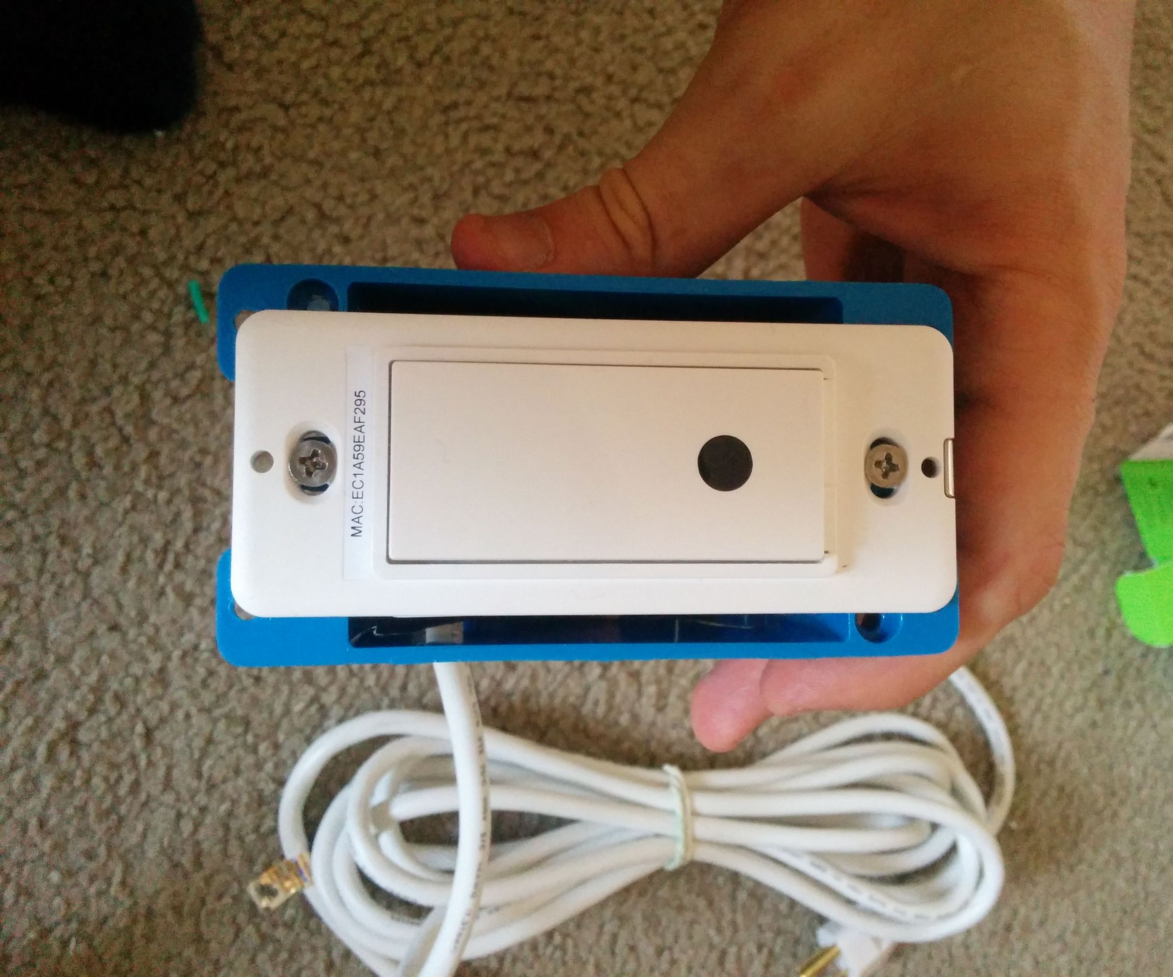

Once you've gotten the wires stripped, take the two cut ends of the extension cord and thread them into the zip box (the blue thing).
At this point the project should look similar to the picture above.
Step 3: Wiring Up the Box and Sealing Away Dangerous Wires
My WeMo came with 4 twist-on XPT connectors (the orange things).
These guys are used to take loose wires and join them together without having to do any soldering. They also shield the wires so that they don't accidentally touch an incorrect wire or YOU.
Do the following:
Take the metal sticking out of the 3 green wires, put them together and screw an XPT connector onto them joining them.
Do the same with the white wires.
Take 1 black wire from the WeMo and join it with 1 black wire from one side of the extension cord with an XPT connector.
Take the other black WeMo wire and join it to the black wire from the other side of the extension cord.
You're done with the wiring. Take your screw driver and push all the wires inside of the blue box and screw down the screws that connect the WeMo to the box.
In the end your box should look like the one pictured above.
At this point the box is pretty safe. You couldn't hurt yourself unless you could slip your fingers into those little slits and touch wires that are covered by XPT connectors. You don't know if the box works yet though and it's time to find out.

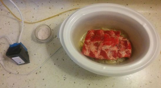

Step 4: Testing the Crock Pot and the Controller
These pictures show my crock pot. It's VERY simple. It has a knob and when it's plugged in and the knob is turned to high, medium, low or warm a little light lights up on the crock pot and it starts to heat up.
We're going to be controlling the power that gets to the crock pot with our extension cord. When the WeMo is switched off there will be no power getting to the crock pot and so the food will not cook. When the WeMo turns on the powered crock pot will heat up and cook the food.
So before we actually cook something let's test to make sure the system will work.
Turn the knob on your crock pot to low.
Take crock pot and plug it into your extension cord. Plug the other end of the extension cord into the wall. Wait for a few seconds while the WeMo boots up. Then you should be able to hit the switch. Hitting the switch should turn the crock pot on and off.

I set my crock pot up today to go on at 4:00pm. I checked my phone around 6 as I headed home from work. Sure enough the crockpot had automatically turned on. By the time I got home dinner was perfectly cooked.
Step 7: It Really Works: Here's My Dinner

Sautée the onion and garlic in the morning and put them in the bottom of the crockpot. Cover them with the meat, salt, pepper, chipotle and stock. Set the crockpot to turn itself on 3 1/2 hours before you get home. When you arrive home enjoy!
