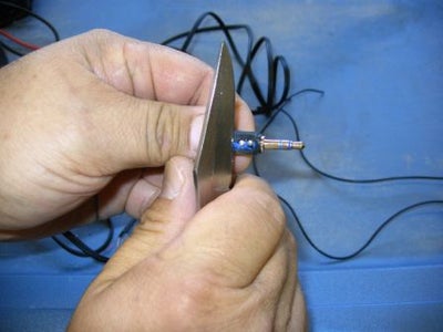

Remove the plastic covering over the 3.5 mm jack. Use a sharp knife to cut away the plastic. This step will vary depending on your headphones, since some use soft plastic, while others use hard plastic. Some may even be conveniently encased in a threaded cover, saving you a lot of trouble.
The audio cord has four wires, corresponding to Left, Right and Mix, I think. I decided to use my own wire, taken from a 5V power adapter. It may be that you can get away with ignoring the wires going to the middle part of the jack (mixed left and right), and connect to your battery with the Left and Right wires directly. That would save a lot of trouble.

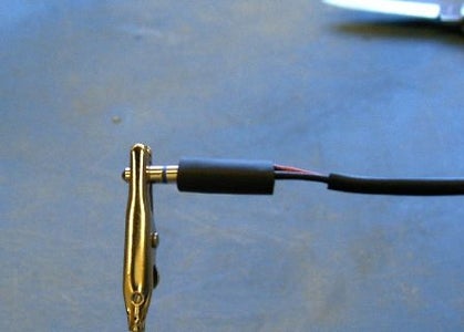

Step 3: Solder Your Power Cord
I am using insulated wire taken from a broken power supply. I had previously found, using my meter, that my headlamp's receptacle would use the tip and base of the 3.5 mm jack, and ignores the middle contact.
Note: Soldering is not shown here. It needs to be done delicately, because the plastic spacers in the jack will melt if you take too long and heat the jack too much. Solder one wire, then let everything cool before soldering the next.
Add a piece of heat shrink tubing to cover your work after you're done. I let the tubing shrink over the wide collar of the jack, then cut it away flush afterward.

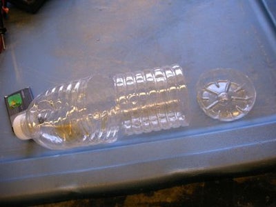

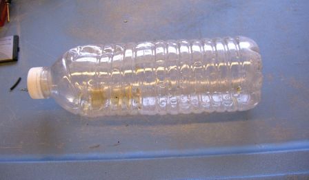

Step 4: Prepare the Shrink-fit Sleeve
Using a PET plastic water bottle, make a sleeve to cover the battery and hold the wire in place.
It is dangerous to solder directly onto the leads of a battery. If your timing is bad, the battery may explode, so the plastic sleeve is used to hold the wires onto the battery contacts by pressure only.

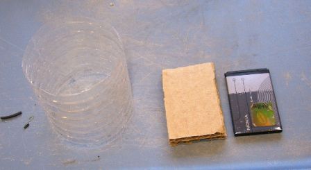

First, cut a uniform cylinder out of the drink bottle. A smooth cut works best, and the cylinder should be wider than the battery.

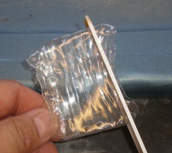

Next, make a 'dummy' battery, slightly larger than the actual battery, out of cardboard. I used two sheets of cardboard for extra thickness.

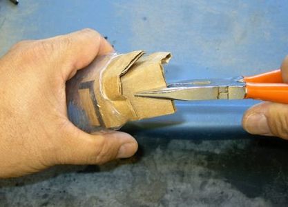

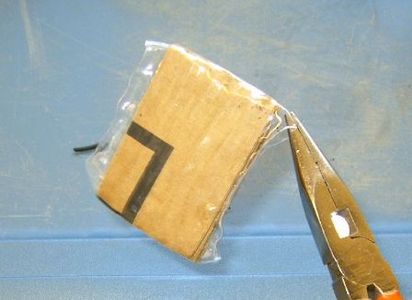

Put the dummy into the plastic cylinder, then use a heat gun to shrink the plastic over the cardboard. Use pliers or forceps to hold the cardboard, since it will be too hot to use your hands.
I do not know if toxic fumes are released by heated PET plastic. To be safer, do this in a well-ventilated area or under a fume hood.
After the plastic is cool, remove the cardboard.

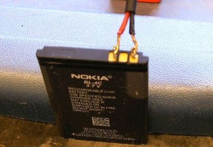

Step 5: Prepare Your Wire Contacts
The contacts on the battery are recessed, and it is dangerous to solder directly onto a battery. Instead, the plastic sleeve will hold the wires in place by pressure alone.

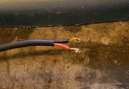

Twist and bend the ends of your wire leads to create a pad that will fit into the recessed battery contacts, then add a bit of solder to create a bulge that will touch the battery. Test your contacts to make sure they fit and do not need too much pressure to stay connected.
Remember, I am following a convention of tip = positive

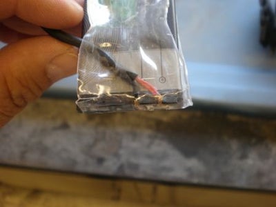

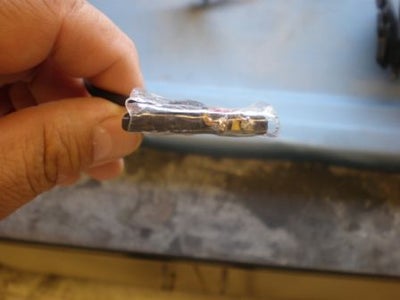

Step 6: Slip the Battery and Wires Into the Sleeve
Trim the rough edges of the plastic sleeve. The edges are more shrunken than the main part of the sleeve, so they must be trimmed to allow the battery to enter. You may want to trim only one side, and leave the other side as a 'stop' for the battery.
The battery and wires can now be slipped into the plastic sleeve. The sleeve is a bit longer than the battery to start, but makes a snug fit when the wires are in place. The pressure holds the wires in contact with the battery.
This step is a bit tricky. I may modify it to use a long sleeve that gives me a loose fit, then tighten everything by introducing a wooden chopstick against the bottom of the battery, forcing it onto the top of the sleeve.

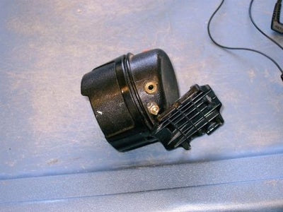

My headlamp uses a 3.5 mm receptacle. I have since used audio receptacles scavenged from broken radios, etc as power inputs for these batteries. Remember that the tip is positive in my setup.
