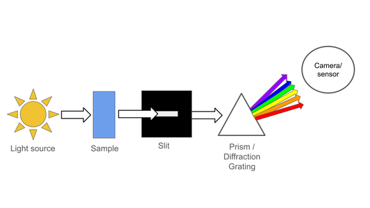

Spectrophotometers are tools used to measure the intensity of light by it's wavelength. The device works by sending a light beam through a material that bends light (refraction) in a way that separates the wavelengths (Spectral Dispersion). This material is usually a prism (I'm sure you've seen this on a t-shirt or poster) or some sort of diffraction grating. In this case, we will be building a device that takes a light beam, sends it through a sample, focuses that light through a slit, passes it through diffraction grating, then records the light as a camera image. This is what's known as an array spectrophotometer.

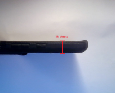

Step 2: Measure Phone Specifications
The spectrophotometer case should fit over your phone, with an opening right in front of the camera. I have made a 3D file with the case dimensions made to fit my Pixel 7. You will need to adjust the file to fit your phone's dimensions. First, measure the key dimensions with a ruler or caliper (for improved accuracy).
  1. Thickness

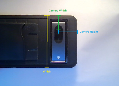

  2. Width
  3. Camera Height = distance from center of back camera to top of phone
  4. Camera Width = distance from center of back camera to LEFT edge of phone
If you live in the 21st century, you likely have multiple back cameras. Typically one of them is the "main" camera. Unfortunately at the present, Android doesn't allow you to manually choose which one to use. Instead decide the main camera by attempting to take a picture of an object a couple feet away in a normally lit room, and placing your finger over the cameras to see which one is in use.

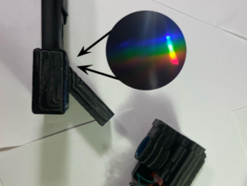

  4. The plastic can be taped over the circular opening, completing the case. Keep the plastic so the inner/outer edge of disk is top/bottom on the camera. The resulting "rainbow" should be vertical.
Step 5: Install Spectrophotometer App
First, test out your new spectrophotometer device. The case should fit over your phone, and when pointing at a light (flat end of the shaft perpendicular to the light source), a rainbow should appear. It might be a little messy depending on how bright the light source is or ambient light. The blue light should be either on the top or bottom (vertical rainbow). If not, rotate the disk/diffraction grating 90°. The rainbow should also be somewhat in the middle of the image.

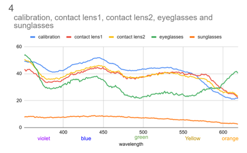

For an example, I recently bought some contacts that advertised themselves as being "blue light filtering". I decided to put that to the test, along with my eyeglasses and a pair of sunglasses.

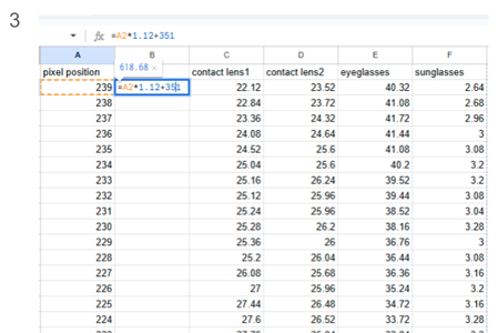

From the emails I sent to myself, I copy + pasted the data in a google sheet. It might be helpful to delete portions if you know there was a glare at the top or bottom of the screen outside of the range of the rainbow.

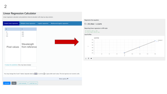

Now we need to use linear regression to align our pixel values with the wavelength (no linear algebra knowledge required)
  1. Find at least two features on your spectra graph to compare to the reference. I chose three, the first peak, first trough, and the second peak. Because all I had was the image of the graph, I had to get a ruler out to measure the points on my screen. If you make a graph in google sheets with your data, you can hoover your mouse over points of interest to get x,y values.
  2. Visit an online linear regression calculator: https://www.statskingdom.com/linear-regression-calculator.html
  3. You will need to first correlate your pixel values to wavelength (nm). Use your measured pixel number as X and the reference wavelength as Y. The resulting equation can be used to transform your pixel numbers to wavelength
  4. Tip: The R2 value (in green writing) gives a measure of how closely the resulting equation fits the data, with 1 being the best and 0 being the worst.
  5. Use the equation you found in Google Sheets to convert your pixel position to wavelength.
  6. Compare your samples' spectra to your calibration. Remember a low intensity value the calibration means that wavelength is being absorbed by your sample. Looking at my own data, I can see there's a bigger gap between contact lens and calibration at the 400nm point than at the 550nm, meaning they are indeed absorbing higher-frequency light. The same doesn't seem to be true of the eyeglasses, however there's some distortion there. As expected the sunglasses abosrbs light at all wavelengths.
