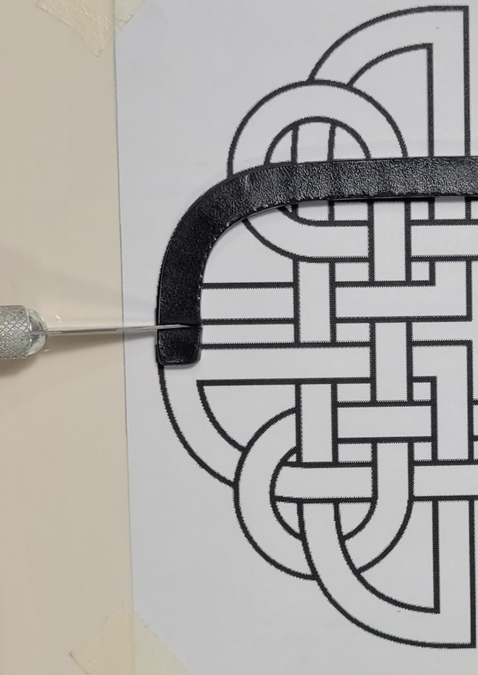

Now we cut strips of clay. Using your ruler, measure the width of the knot's lines; mine are 1/4 inch wide. Mark the clay lightly with dots or lines at the appropriate width. Using the ruler as a straight-edge guide, align the ruler on your marks. (*Tip: Gently scoring the clay along the edge of the ruler, making multiple passes, will produce a nice, even strip. Clay tends to want to pull out of alignment if you cut straight through in one pass, leaving you with a wonky length of clay.) Cut the end of your strip, making a 90° angle for our starting piece.
Step 4: Placing Your Clay
Place your first clay piece on your work surface following the contours of one of the Dara lines. (*Tip: When you come to the end of a line, it helps to trim the end just a tad longer to compensate for the extra slack needed for weaving the clay.) Cut another strip of clay and add the next piece, following the design around, weaving the clay over or under the previous piece by very gently lifting the clay with your fingers or tool, being careful not to squish the clay. Continue adding clay strips. The more clay you add, the more you cover up the image, which can cause you to lose track of which piece goes over or under. This is where having an extra copy of your design to refer to comes in handy. It's easy to lose your place. (*Tip: The inner, more rounded line can get pretty tricky. Take your time, don't rush. Your eyes will cross, and it may look like a mess, but trust the process. You can do this!)
