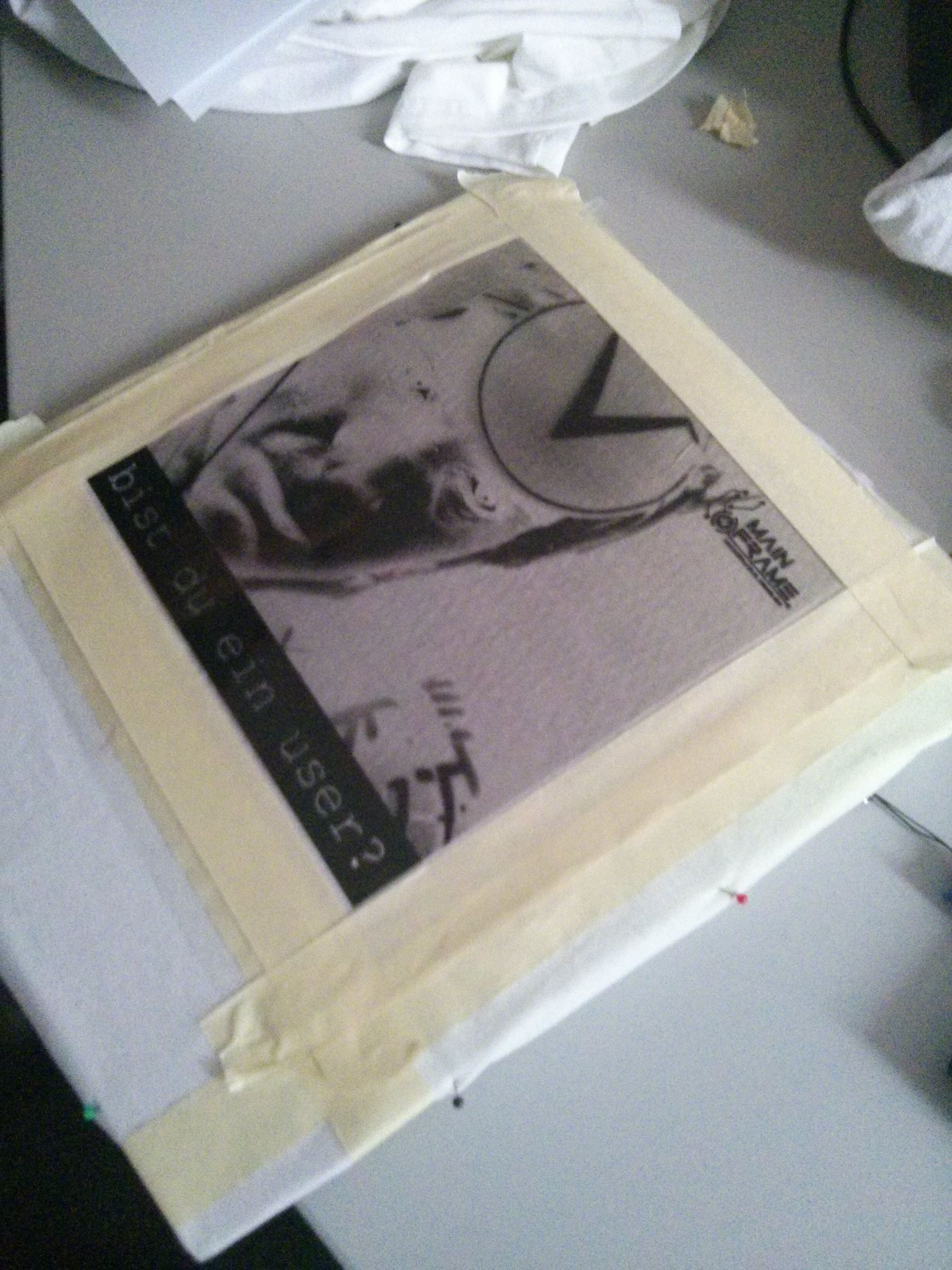

To be honest, we did not cut the leather immediately - we tried it with Polypropylen first (a plastic which is good to laser). So I produced two little plastic shoes. Later, we tried to cut leather, but we forgot to re-focus the laser cutter, so instead it produced brand design in the leather (right side of the picture).
But then we lasered with the correct settings and produced two little leather shoe forms including all the punch holes. This saves a lot of time in the last step!
Leather is a nice material to cut. However, it really smells burned (well, it is burned). So make sure that your exhaust system works properly.
The leather will smell, too. I used a cream colored leather and the cutting edges all were pitch black. But then I washed the leather and let it dry; the edges changed to a light brown, and after 3-4 days, the burned smell went away, too.
