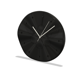

Using Fusion360, I modelled several versions of this clock concept until I came across a form I was satisfied with.
Clock concepts
Clock concepts
Clock concepts

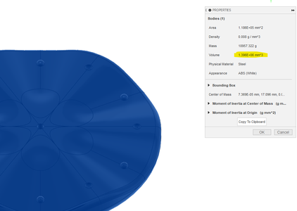

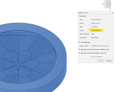

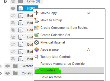

  3. Analysis Tools. Fusion 360 made it easy to plan out the whole process. You can plan out your project by modeling the urethane mold and cement pour, and then viewing the properties to see how much volume of material you will need. (ex. 1.469E+06mm^3 is equal to 1469 ml of liquid). Using that, I was able to estimate how much Vytaflex and cement all I would need and plan my mixing vessels accordingly.
  4. Planning. By modeling the urethane mold and cement cast, I was able to preview what my each step would look like before I progress. I added a layer of complexity by designing a jig to create the void for the clock mechanism. The void screws into a base piece, so the depth can be easily adjusted.

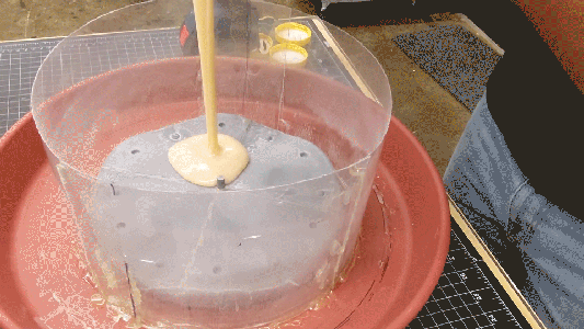

  1. Using the hot glue gun, secure your master to the planter saucer. Make sure its flat against the bottom so the rubber doesn't get under the master.
  2. Measure and mark where the border will be with a sharpie. You should leave about a minimum of 0.5" inches of space between the border and the model. You should also consider either coating and edges of the model now because it might be harder to get around the edges after you glue down the border.
  3. Use the hot glue to secure the flexible border around your master. Make sure to fill in all the gaps!

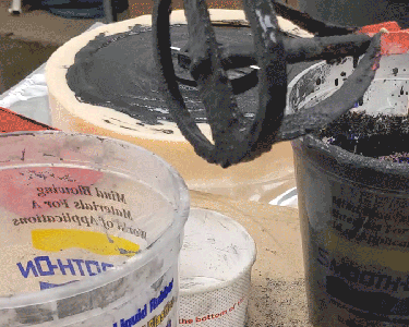

  4. Get your mixing tools ready and mix the Vytaflex according to the instructions. Using the drill attachment, mixing should be a breeze.
  5. Coat your master model and the inside of the border in the mold release of your choosing.
  6. Pour, starting from one side and let the rubber spread and flow around the model.
  7. Wait. Vytaflex takes around 16 hours to cure. If you have extra vytaflex, you can use that as a gauge to know when your main mold has set.

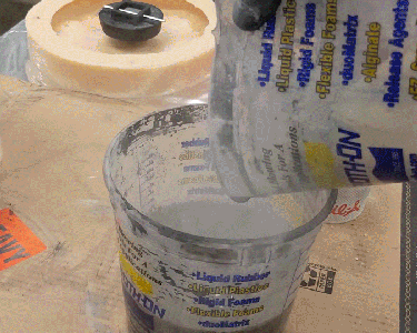

  • The instructions for Cement All call for a 4-1 ratio, but I found a higher water ratio was easier to work with, and left a smoother finish on the back side. Measure out a 3-1 ratio and add more Cement All to get a smooth consistency. It shouldn't be watery, but it also shouldn't be too thick. (I suggest practicing a small amount)
  • A tip I learned was to have small extra molds on hand, so pour extra cement into so you don't waste anything. You can find coaster molds at hobby store or Amazon.
  1. Optional. If you decided to do extra credit, assemble your void jig into the mold.
  2. If you calculated how much you would need with Fusion360, make sure to mix more than enough.
  3. Add your pigment powder to the Cement All, mix, then add it to the water
  4. Use the drill with the mixing attachment to mix the cement. Check the drill attachment for clumps and remix if necessary.
  5. Pour, starting from one side and let the cement mixture flow underneath your optional void jig.
  6. Vibrate the mold (careful not to spill) to remove bubbles to have a smooth finish on the top.

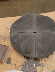

  1. Carefully remove the clock from the mold. If you used a jig for your void, double check the dimension to make sure everything is where you want it to be, otherwise you might need to buy a new mechanism.
  2. Break off what you can with your hands, and then use some sanding tools to smooth out the rough edges of the back.
  3. Optional. Sand the outer surface of your clock. I used 600 grit wet sand paper because my master was already very smooth. If your master was made from multiple pieces, there might be seams you may also want to sand out.

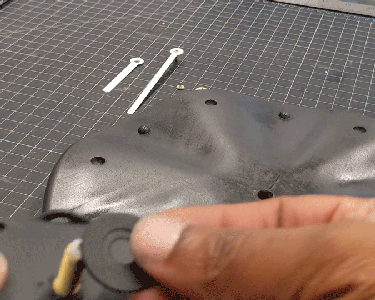

Step 9: Add the Mechanism
Measure the gap for clock mechanism. The Cement All pushed my void out a bit, and ended up making the gap go from 1 cm to almost 2 cm, so double check the gap and buy a new mechanism if needed (or account for the gap).
  • When you put the clock hands on, align them all at 12 so they are in sync, and then set them to your current time.
