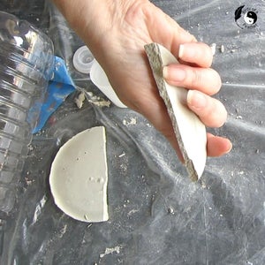

With the leftover cement, let it dry in the plastic container. Nothing goes to waste: we’ll use it later as a sanding block.

Step 9: Sand the Seams
If you don't mind the seams, you can just leave them. Or you can use the cement puck you made from the leftover cement as a sanding block to sand the ridges on the sides of the planter.
