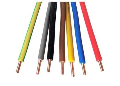

We will use the solid core wire around the lamp ring. Strip 6 x 350mm copper wire and insert this in all the galleries of the lamp.
Solder all the connectors and wires together. The data wire (middle connector) should not contact each other. The power can be one solid wire.
