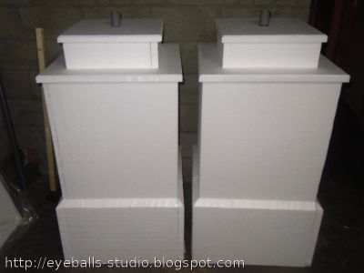

Step 2: Styrofoam Panels
With the frame ready, it's time to glue the styrofoam panels on! I started by wrapping the entire box in 2 cm thick slabs. Now if only I thought about the measurements before I got started! The dimensions of the box are 52,4 x 52,4 x 100 cm. My styrofoam slabs are 50 x 100 cm. The perfect dimensions for the box would have been 48 x 48 x 100 cm, because then I could just glue 4 entire sheets on it and I wouldn't have to cut anything.
Next, I wrapped the lower 40 cm with a 3 cm thick slab, with the top edge cut at 45°. The top is built from a series of 3 cm thick pieces so it forms a protrusion, making the entire pillar about 120 cm high. One more thing left to finish the styrofoam construction: cutting bricks in the styrofoam using a wood burning tool. I think the final result looks quite ok!

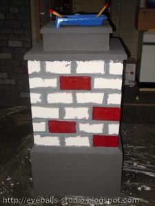

Two days later, the monster mud was dry enough and I could start painting. I started by painting the mortar between the bricks gray, followed by the base and the top. For the mortar I used a paint brush, but for the rest a roller. Works much, much faster!
Next, I painted the bricks. I mixed some red and brown paint to get the typical dark red brick color. I started by painting a few bricks all over the pillar first, before mixing up a fresh batch of paint. The idea behind this was that this way, all bricks would have a slightly different color. It didn't really work, though, all of them turned out the same color.
