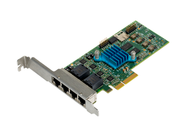

- A redundant network interface card

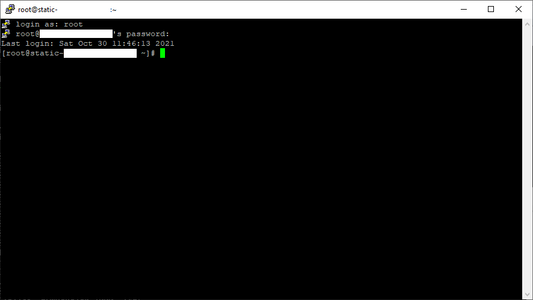

- Access the machine via SSH using tools such as PuTTY.

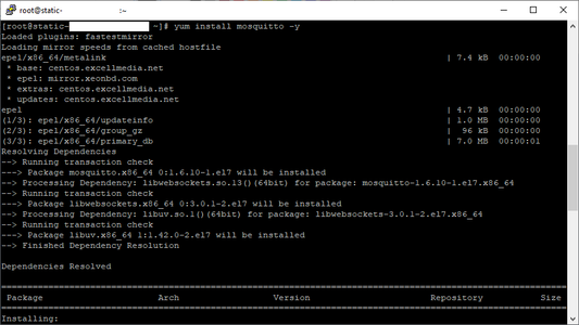

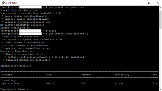

- EPEL Release: yum install epel-release -y
- Install Mosquitto: yum install mosquito -y

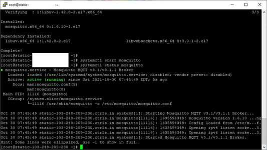

There is one more step before we move to the next phase of explanation, which is to start the "mosquito" service and enable it
- systemctl start mosquitto
- systemctl status mosquitto
- systemctl enable mosquitto

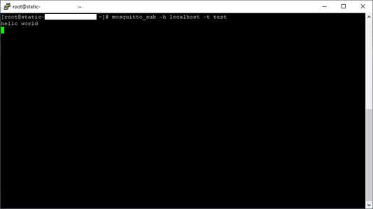

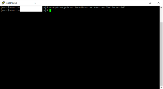

Step 3: Testing Mosquitto Installation

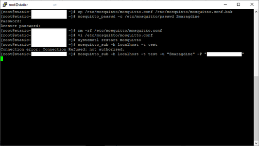

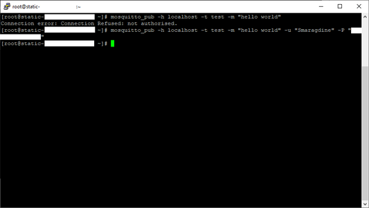

Now that the mosquitto service is started & enabled, it is time we test for its functionality on the localhost. To conduct this test, we will need two SSH terminals one to execute: "mosquitto_sub" and the other to execute "mosquitto_pub" commands

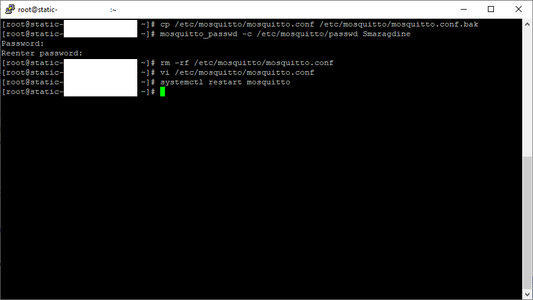

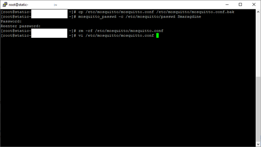

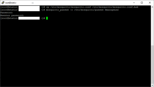

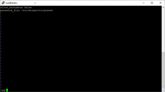

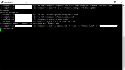

Step 4: Securing "mosquitto"
Security remains a top priority to any IT Infrastructure Administrator and it is very much advisable to have an authorized user to have to give access to allow data logged onto the server.

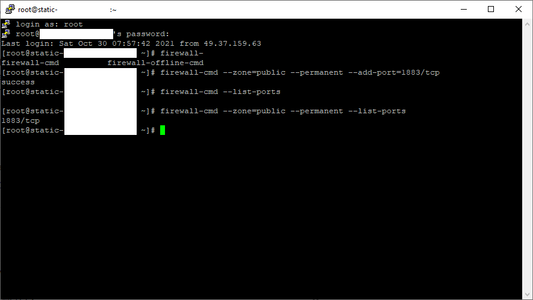

Step 5: Allow Data Via Firewall Port: 1883 and Service: Mqtt

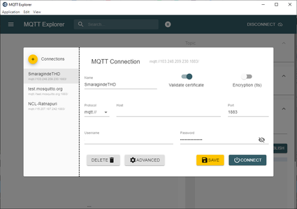

Allow port "1883" and service "mqtt" to pass through the firewall and test it with third-party tools such as "MQTT Explorer"
- firewall-cmd --zone=public --permanent --add-port=1883/tcp
- firewall-cmd --zone=public --permanent --add-service=mqtt
- firewall-cmd --reload
- firewall-cmd --zone=public --permanent --list-ports
For successful capture of data to third-party tools such as "MQTT Explorer", CentOS 7 machine may be required to be configured with "httpd" service. In such a case the IT Infrastructure Administrator is advised to let the connected port and service pass through the firewall.
