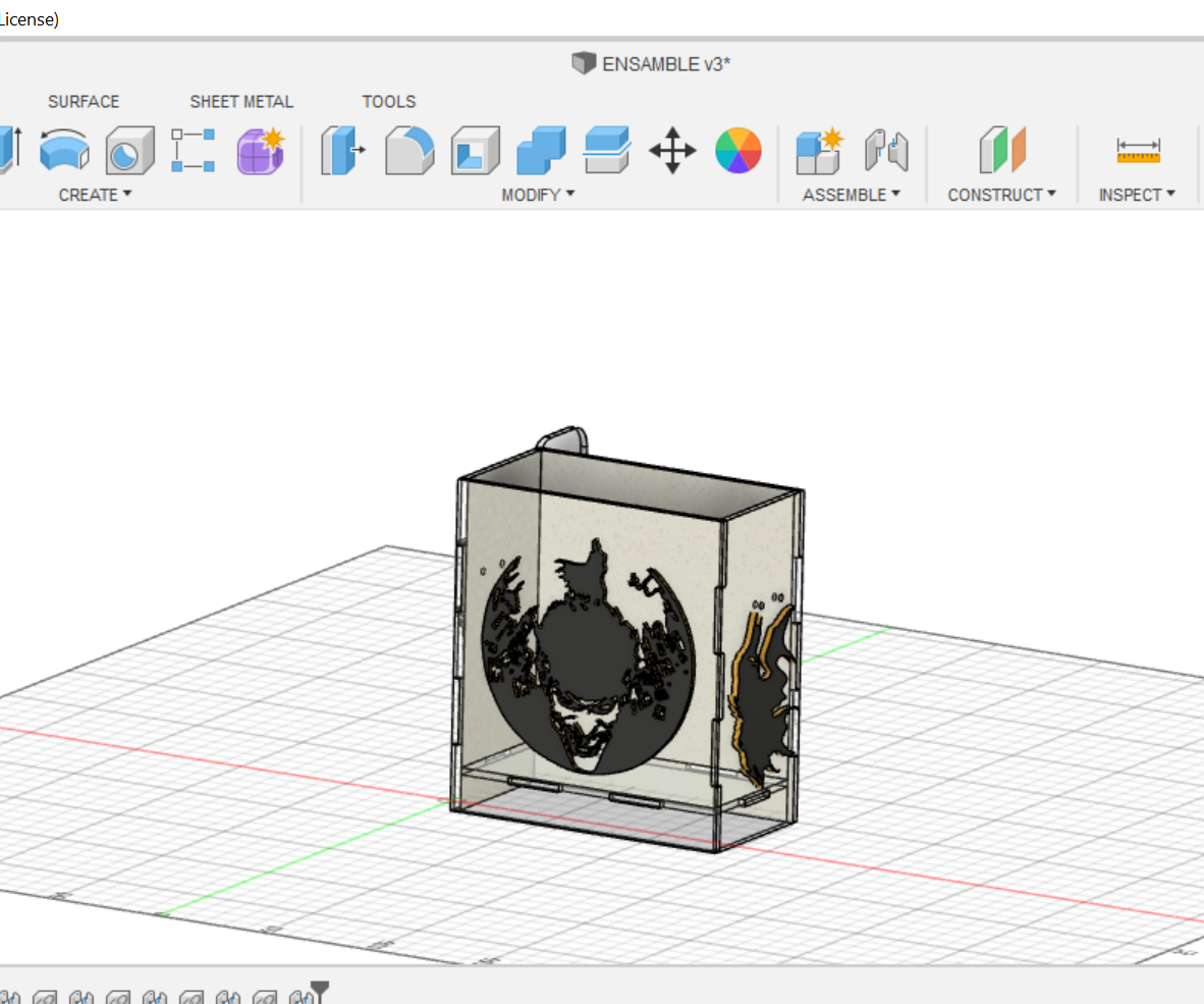

Introduction: Center Table

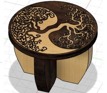

In this tutorial we will make a center table using fusion 360.
This is an easy project to perform and comprises three parts.
Step 1:

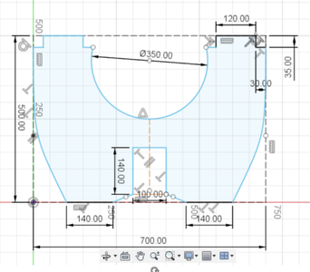

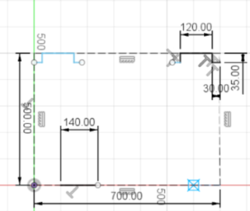

We will start with the base that consists of two pieces.

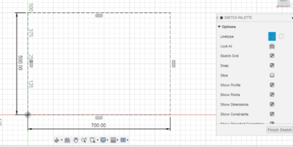

First we have to make a rectangle with 500 x 700 mm constrution lines. At the top, we draw lines with a distance of 120 mm and 30 mm.Then down to 35 mm.
Next, we draw two 140mm lines on each side, slightly set back from the sides.
Step 2:

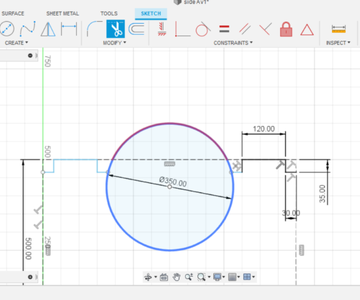

Then connect the upper rows with a 350 mm circle. We cut parts that we don't use.
Step 3:
We connect the top and bottom with "conic curve".

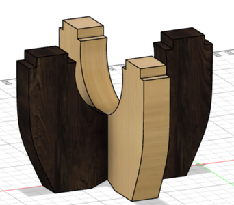

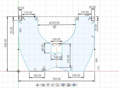

The two parts are the same except for the holes that will be used to connect them. The dimensions of these in A are 100 x 90 mm and 100 x 140 mm B.
these are in the lower half of the circle and the upper half of the base.

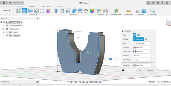

Step 4:
We extruded and then use both give a thickness of 100 mm.

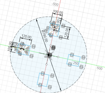

Step 5:
We will make a 780mm circle for the last part.
Then extrude to 50 mm and then make boxes 100 x 120 mm in the same plane. Will use after construction lines 130 mm to position the rectangle, also use the central rectangle funsion.
We use extrude with -35 mm in the rectangles.

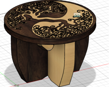

Step 6:
If you want, you can insert an image and use Fit Point Spline to achieve the design you want. Change it too using appearance (modify).
Step 7:
Finally you end up joining parts using joint(Assemble).
