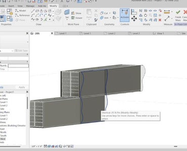

Step 3: Cargo Container
Step 1 - Shipping container
Each level can be constructed using two 20’ containers or another standard shipping container size of 40’
The Door (picture 4)--
First I started with a metric generic template to create a door family that could open and closes. First, I created an extrusion line to represent the height of the container. Then, I made two more extrusion lines in this line and evenly spaced them out using the dimension tool. then I made two little notches using these dimension lines for placements. I then deleted the two extrusion lines that helped me with these elements. Then, I used the trim and extended tool to connect my notches to the high extrusion line. Then, I offset this element by 1 cm and capped the open lines at the ends. And for the extrusion end, I put 120cm, and the extrusion start at -120cm. Next. Finally, I went into the front view and created a rectangle around what I have already created to become the shape of a door and then offset this rectangle by 10cm. then, I joined these elements and that is the door.
The Supports (picture 3)--
I create a new generic family model and added some reference planes to mark my perimeter and used the dimension tool to create a perimeter of the length, giving me the ability to change the length of this container. Then I imported my door and locked it to the center point so it slides along the middle. And then I mirrored this element to the other side. Next, I went to the left view and made little square extrusions on all four sides of the container door and then connected these lines to the other door to act as supports.

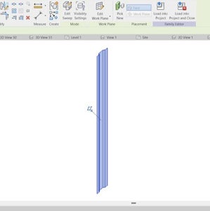

The Ribs (picture 2)--
I created the rips that would make up the shipping container's sides. (I am not going to explain this part because it is almost exactly like what I did for the door notches but only this time it was only the rip not connected to the door. )
(picture 1)
Then I imported this rip into the family with the doors and aligned it to the supports and just used the array tool to line it up all along the container's sides, to get the final result as you can see in the picture.
