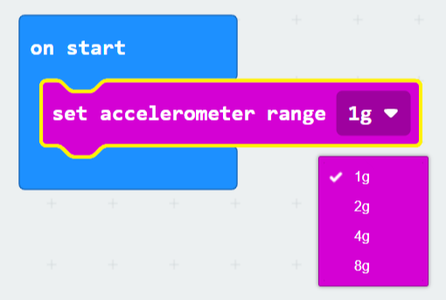

We will use the accelerometer sensor to measure acceleration along 3 axes (x, y, and z). The measurement unit is milli-g (where g = 9.8 m/s2). This sensor is set to measure up to 2g by default. You can use "set accelerometer range" to alter the measurement range to 8g.

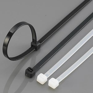

  3. Firmly attach micro:bit to the basket using 2 cable ties.

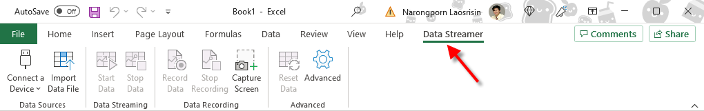

Step 7: Enable the Data Streamer Add-in
What is Data Streamer?
Data Streamer is an add-in that enables Excel to receive data from a microcontroller in real time. We can connect microcontroller (such as Arduino or micro:bit) via USB cable, then stream live data to Excel for complicated computation and data visualization.

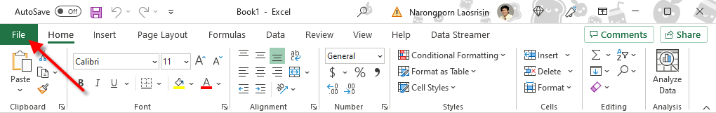

To use Data Streamer add-in, you first need to enable the add-in by following these steps:
  1. Click File menu.
  2. Click Options.
  3. When Excel Options dialog appears, click Add-Ins.
  4. Select COM Add-ins, then click Go.
  5. Select Microsoft Data Streamer for Excel in the COM add-Ins dialog, then click OK.
  6. You will see Data Streamer tab in the Excel ribbon.

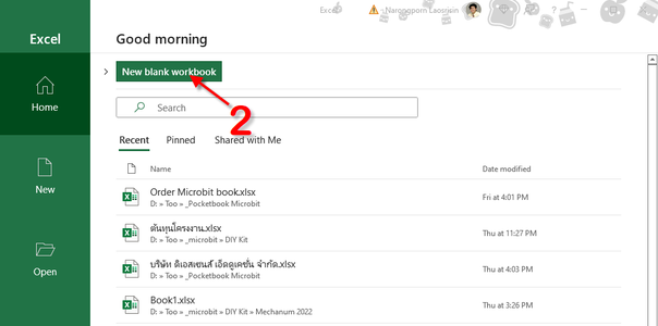

  1. Connect micro:bit (receiver side) to your computer via USB cable.
  2. Launch Microsoft Excel with new blank workbook.

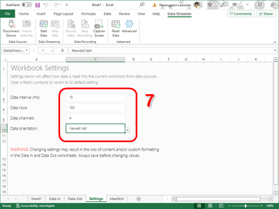

  6. Excel will create 4 new sheets: Data In, Data Out, Settings, and Manifest. Open the Settings sheet.
  7. Change workbook setting to following value (Data interval = 10ms, Data row = 100 or more, Data channels = 4 and Data orientation = Newest last.

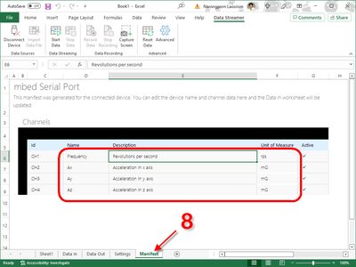

  8. Open the "Manifest" sheet, then define each data channel's Name, Description, and Unit of Measure.

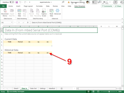

  9. Switch back to the Data in sheet. According to the Manifest sheet, you will notice that the channel name has been changed.

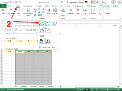

Step 10: Visualize Data With Scatter Chart

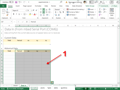

To help you see the data more interestingly, I will use a scatter chart to show the relation between period of revolution and acceleration on 3 axes.
  1. Select data range to include channel name and all data rows.
  2. Click Insert menu, then select Scatter Chart.
  3. Re-position and scale the chart as you wish.

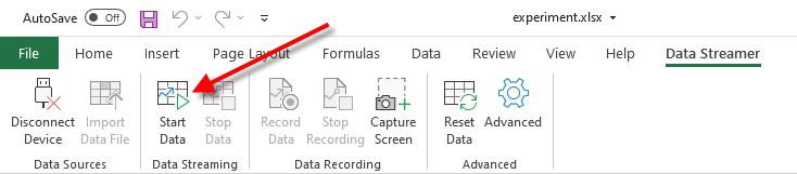

  3. On the Data Streamer ribbon, click “Connect Device” and “Start Data” to begin receiving data from the micro:bit
  4. Start rotating the spinner and see the result.
  5. Click “Stop Data” to stop receiving data from micro:bit and click “Reset Data” to clear all data.
