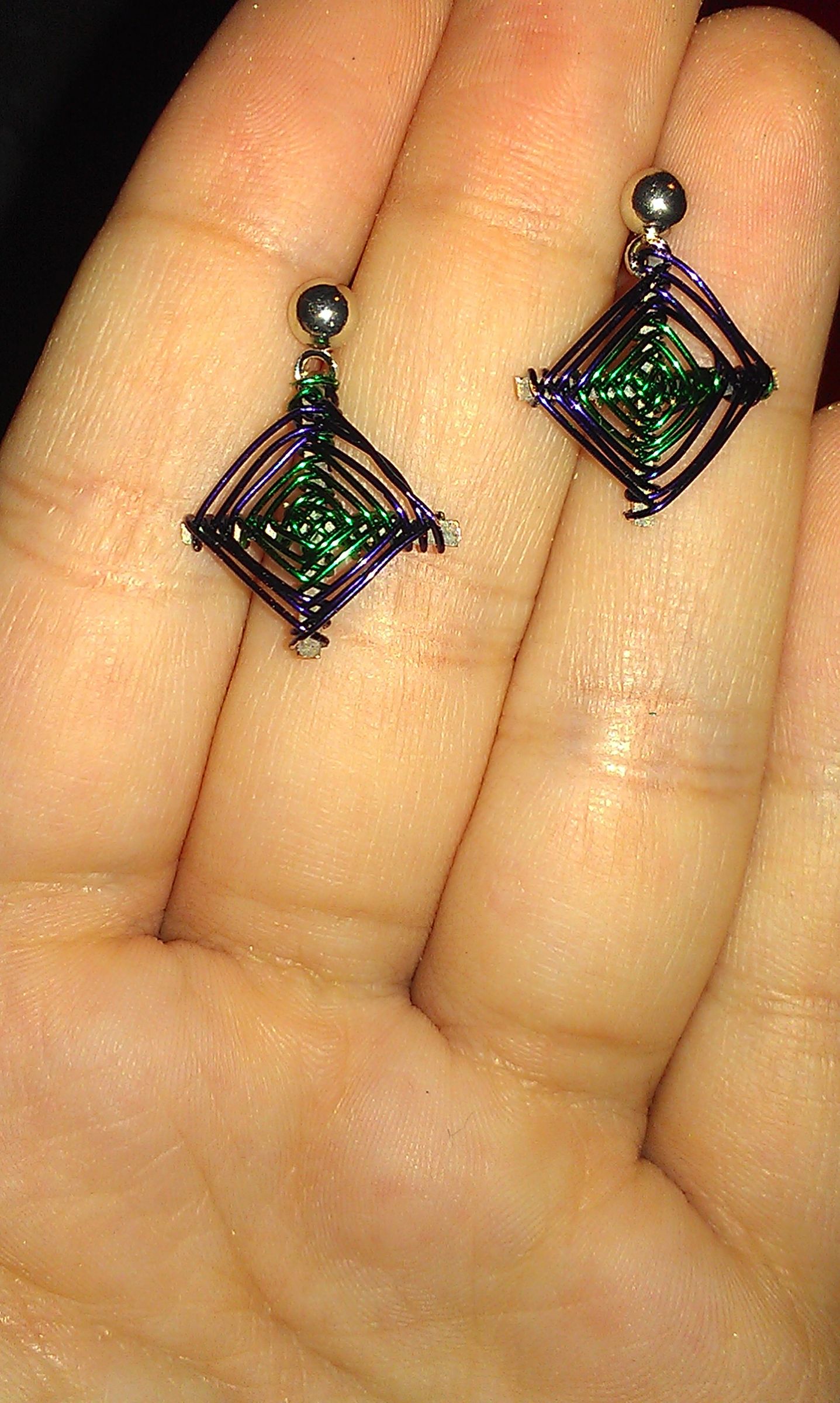

Now that you know some chainmaille basics, you can make earrings or other things.
Pictured is a set of somewhat matching earrings that I made. First, I laid out the jumps rings needed, then connected them up. Be careful with earrings, though, because chainmaille can get a bit heavy, and if your ears aren't used to it, you don't want to overdo it.
