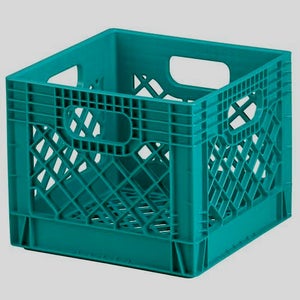

Step 1: The Container
The design is probably self-evident after looking at a few photos. The key element is one of those plastic milk crates that are everywhere. They are available to purchase if you don't have one lying around.
It's helpful to have a permanent marker, a ruler or square, and a cutting device (other than your chainsaw!).

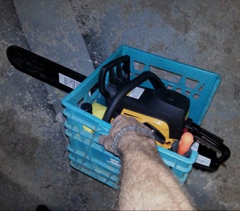

Step 2: The Back Opening
This step will depend on the size and shape of your particular chainsaw. A milk crate should work for just about everything, regardless of bar length. If your crate has "handles" I found it most convenient to keep them on the sides.
I simply put the chainsaw on top and determined how much of the back needed to be removed - so that the chainsaw would easily slide through the new opening. I suggest leaving a bit of the corners for overall strength.

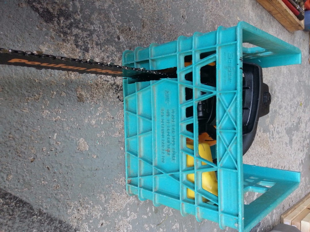

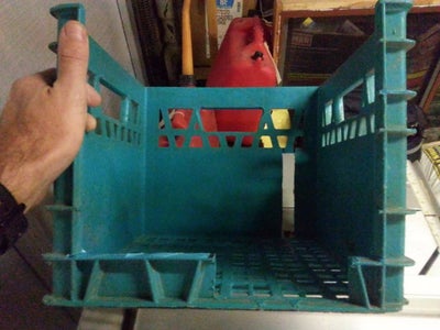

Step 4: The Front Opening
This part can be a bit fussy. You'll need to place your chainsaw as far into the milk crate as possible and see where the bar touches the front. This is where you need to cut a hole for the bar to poke through.
I made my hole about 3/4" wide and 1" taller than the bar itself. I wanted it to slide through quickly & easily without getting caught on the chain links. After making guidelines with a marker I used a jig-saw for this cut.

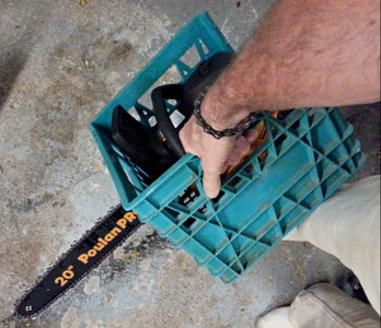

Step 5: The Back Cutaway
This is the final cut, and it depends on the shape of your chainsaw. In order to have the saw sitting on the bottom of the crate you'll need to remove a piece of the crate lip. I made a quick visual estimate and then cut it out.
Your chainsaw should now fit comfortably inside the milk crate. My cutaway also keeps the chainsaw from sliding back out the opening.

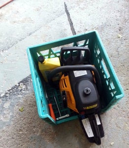

Step 6: The Finished Product
And there you have it. Room for a chainsaw and all the accessories. I find the loaded crate naturally leans forward when I pick it up so there's no need to worry about things slipping out the back. You could add a bungee cord for extra security. (Thanks "Jobar007".)
Thanks for looking at my Instructable and I hope it works for you. Good luck!
Step 7: Update - the Bar Guard
I just added a bar guard (scabbard) from Walmart Canada to complete the package (20" plastic guard for $6.98). If your crate's front hole is big enough you can slip the chainsaw bar through it with the guard attached... works like a charm.

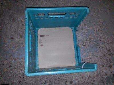

Step 8: Update - the Crate Base
This isn't much of an update - but it's a nice touch. I find my chainsaw is a little leaky - usually because of dripping bar oil. So I put down a layer of cardboard on the bottom of the crate and VOILA... the leak is mopped up. It's easy to change out when the cardboard gets saturated.

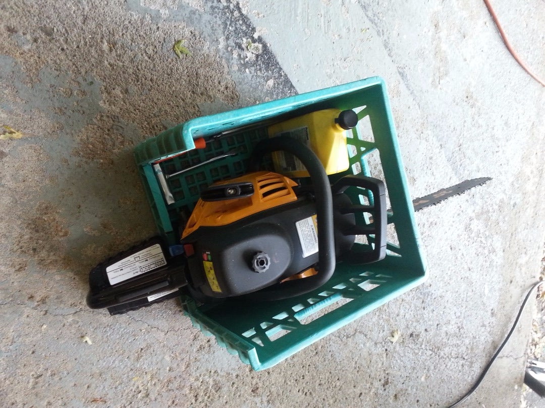

Step 9: Update - Tool Holder
This one is thanks to a comment from "QuentinB1". He suggested using a piece of PVC pipe in the corner to hold loose tools like the file and such. Great idea! I cut a piece of 1-1/4" pipe ten inches long and then zip-tied it into the corner. Does the job nicely. (You may have to choose an alternate location if the chainsaw is wide and doesn't slip by the pipe easily.)
