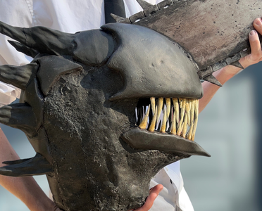

Step 1: Time to Start the 3D Printing
To make the head base for Chainsaw man and the Chains for the chainsaws I used 3D printing. I modelled all the parts myself and I've uploaded them here so you can download the files to make this for yourself.
Thingiverse Link: https://www.thingiverse.com/thing:6267681
I highly recommend using the full scale helmet as a way to measure your helmet before printing. I used a 3D model of a mannequin head I found on Thingiverse to measure my head inside of the helmet but if you have a different method you prefer do that. I also highly recommend having a few cm allowance on both sides of the helmet, it makes it easier to wear when we add the magnets in a later step. And even with me measuring my head the fit ended up being very tight on my head which is good for the seamless look but hurts to wear for a long time.
As for the print prep, I printed the whole of the head in 8 separate pieces, and glued them together. Unless you have a massive printer and really don't care about filament costs you could print the whole helmet in one go, but printing split is by far the easiest option.
There's no real specifics on what slicer settings I used. You can use the exact same settings I used or tweak them yourself. I just recommend keeping the infill light as the helmet can get quite heavy to wear for long periods of time even at 5% infill.
CURA Settings I used:
Layer Height: 0.08mm
Infill: 5%
Walls: 2
Supports: Tree
Step 2: Prepping and Putting the Prints Together
(Just a side note real quick: Some of the photos will have some portions of the Helmet painted, I go into detail on how I painted the whole thing on a later step this was just me experimenting with paints in the moment so you don't have to worry about it)
My prints came off of the print bed a bit scuffed so they required a lot of work to make them look clean. The first thing I did was apply spackle across the armor portions to fill in any layer lines that appeared from the print, as well as fixing any holes caused from printing errors.
Make sure to have the front round part of the head as smooth as you can possibly get it. This part is meant to look super clean and smooth so you don't want to have any layer lines showing. The spikes and armour plating on the back of the head should also be as smooth as you can get them as they will be fully exposed. The main body of the helmet (Areas without armour plating or spikes) will be covered in silicone later so you won't have to worry about getting that super smooth.
Once you have your prints prepped and sanded we can start gluing them together. The whole helmet is only 8 pieces and they glue together among the seams. I just used a hot glue gun and cleaned up the edges when that dried, then went over each seam with superglue to reinforce.
Once you've glued the whole thing together cover the seams using spackle and sand that down. Particularly on the front and back of the helmet where the armor plating is so the whole thing looks like one cohesive piece.
Finally we're going to cut out a chunk of the helmet to fit the chainsaws better. There's already a hole for the chainsaws but to make the chainsaws angled better I cut a hole from the top of the initial chainsaw hole, all the way up to the top of the armor plating
Step 3: Breaking It All Apart (And Then Putting It Back Together Again)
Now once you have the whole thing printed and put together you may be noticing that you can't actually put it on very easily if at all. The neck hole should be too small to fit your head in. The way to remedy this is to make the back of the helmet detachable. The way I did this was by marking out a line on the side of the helmet in a "U" shape weaving in-between the armour panels on the back of the head. Then I cut this out very carefully with a rotary attachment on my dremmel.
With the backplate now a separate piece you can add magnets to the inside to connect the pieces that way you can slide the helmet on and off really easily. I didn't include any proper slots to add magnets I just melted some of the helmet and hot glued the magnets into place making sure that the magnets in the main body and the backplate lined up. Once glued in with hot glue I'd recommend adding an extra layer of super glue on top of the magnets to make sure they are extremely secure.
Now that the helmet is split into two parts and is wearable we have to hide the seam for the backplate. The way I did this initially was I superglued some toilet paper over the seam and cut down it across the seam. This significantly decreased the size of the seam and made it easier for the next step.
Once the seam is covered in toilet paper I went over the entirety of the main body (The fleshy bits not the armour parts) with a layer of hot glue. This added lots of rigidity to the helmet (But in all fairness could probably be skipped all together if you apply a thicker layer of silicone in the next step). To make sure the hot glue was even all over I melted it lightly with a blowtorch, though a hair dryer would probably work if you were more patient than I was.
Finally to finish off the helmet we'll apply a thin layer of silicone to act as synthetic skin. I just got a tube of caulking silicone and poured out a little bit at a time onto a plate, then I would dab the silicone using a sponge onto the areas of the helmet where there was meant to be skin. I made sure to go heavier over the seam for the backplate because if you layer this on thick enough the seam becomes virtually invisible.
