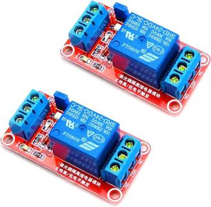

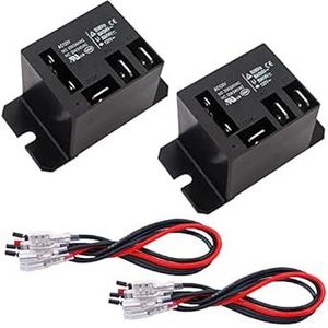

relay (type depends on your change machine brand) For my 24v standard https://a.co/d/4sleMeM my 120v hamilton https://a.co/d/9Oh8v2h

turn on the Out of order light and Use a MultiMeter and test the voltage of your out of order light. also which wire is + and Which is Ground.
My Old Hamiltons are 120v AC
My Old Standard with a replacement Controller is 24vDC
Yours may be different, and what relay you buy will depend what your voltage is.
Step 2: Connect Out of Order Light to Relay
using Wire Taps, Tap into the + Side of the Out of order light and run it to the + side of the relay input
And The negative to negative. On some relays you may need to also Jumper from the + to the "In"

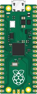

Step 3: Connect Relay to Pi Pico W
Connect a line from "NO" (Normally Open) on the realy to Pin 4 on the Pi Pico W.
Connect a line from "Com" (common) on the realy to any Ground pin on the pico.

Step 4: Program Pi Pico
First update the firmware of the Pi Pico w https://a.co/d/6snHIRc
Download and install Thonny https://thonny.org/
using thonny (ask Chatgpt) Upload umail.py to the Pico
open main.py
Lines 16 to 18 change your SSID, and Wifi password. make sure to keep it between the ` `
lines 20 to 25 enter your smtp server username password
line 25 you can enter as many email addresses as you like, Separated by a comma ,
if you want it to text your phone also you will have to find your Cell phone carriers email to text address. Example .For at&t it is phonenumber@txt.att.net
This code also is set to check each Pin every 5 seconds, If a pin is triggered, an alert is sent, and that pin is ignored for 1 hour, after 1 hour it will send another email and ignore for another hour until the Out of order is reset.
