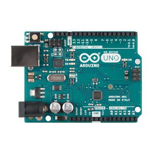

Step 3: Start Visuino, and Select the Arduino UNO Board Type
The Visuino: https://www.visuino.eu also needs to be installed. Download Free version or register for a Free Trial.

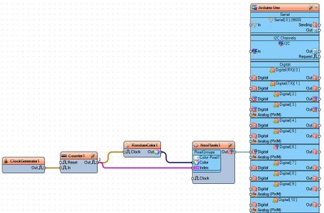

Start Visuino as shown in the first picture Click on the "Tools" button on the Arduino component (Picture 1) in Visuino When the dialog appears, select "Arduino UNO" as shown on Picture 2

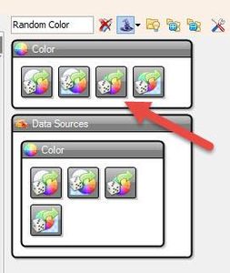

  • Add "Random Color" component

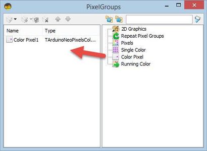

  • Double click on the "NeoPixels1" and in the "Pixel Groups" window Drag ""Color Pixel" window" to the left side and in the properties window set "Count Pixels" to 40
  • Close "Pixel Groups" window
Step 6: In Visuino Connect Components
  • Connect "ClockGenerator1" pin [Out] to "Counter1" pin [In]
  • Connect "Counter1" pin [Out] to "RandomColor1" pin [Clock]
  • Connect "Counter1" pin [Out] to "NeoPixels1" > Color Pixel1 > pin [Index]
  • Connect "RandomColor1" pin [Out] to "NeoPixels1" > Color Pixel1 > pin [Color]

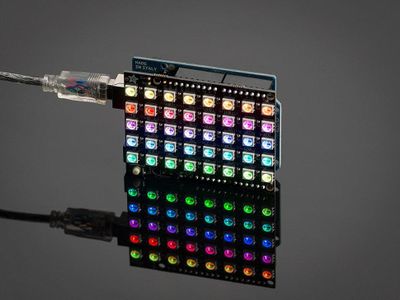

If you power the Arduino module the LED Pixel Matrix Pixels will start to randomly change color.
