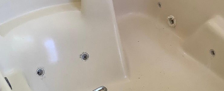

My bathroom tub (see image 1) has eight jets connected to a motor which produces a whirlpool motion and bubbles. About a decade ago I stopped using the jets, so I disconnected the motor. However, over the years, dirt and bacteria have gotten into the jets. In order to have a clean and healthy tub, I decided to change my jet tub into a soaking tub. The process involved removing the jets and exterior rings, filling in the openings, covering the openings, and siliconing the covers.

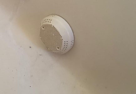

1. The eight jets (see image 1) and the suction cover (see image 2) need to be removed.
2. The suction cover is attached using two screws. Remove the two screws and pull off the Suction Cover (see image 3).

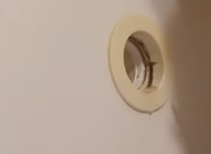

3. Use a wrench (see image 4) or pliers to rotate each jet counterclockwise and then pull it out (see image 5).
4. Clean the dirty outer ring (see image 6) using vinegar or your favorite tub cleaner and a toothbrush. Make sure the outside ring is clean (see image 7).

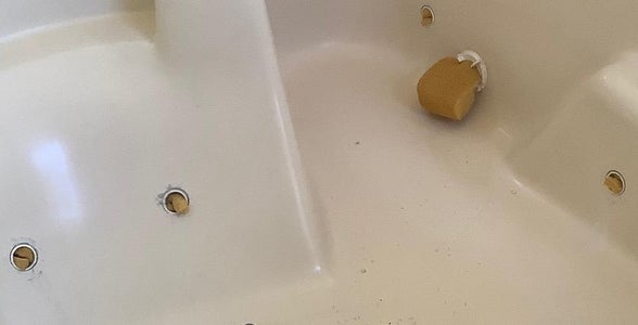

Step 6: Fill Openings With Silicone
1. Fill each opening with silicone (see image 1).
Note: I used a clear (not specifically water-proof) silicone for this step. I applied it using a caulking gun.

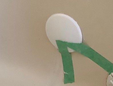

Step 7: Glue on Covers
1. Mix the epoxy glue (per instructions on the packaging). Be sure to wear a mask and plastic gloves.
2. Remove the paper on the back of the wall protector.
3. Apply glue to the back of the wall protector and to the tub.
4. Press the wall protector against the the tub.
5. Hold in place for one minute.
6. Apply painters tape over the wall protector to hold in place (see image 1).
7. Repeat for each jet.
8. Let set overnight.
