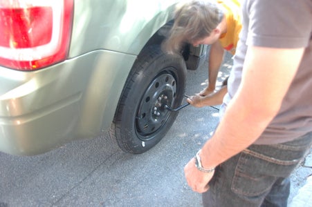

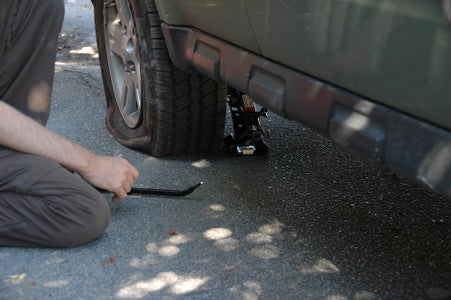

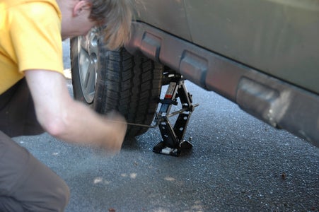

Step 3: Break the Nuts
Get your friend to "break" (loosen) the nuts holding the wheel on before he jacks the car up. Otherwise when he tries to turn them, the force he applies may rotate the wheel instead of turning the nut.

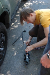

Step 4: Place the Jack
Make sure your friend checks that the parking brake is set, and sets a chock in front of the other tires so the car doesn't roll away. Have him look at the diagram in the owner's manual to determine which points in the frame are solid enough to place the jack under.
Step 5: Jack Up the Car
Have your friend crank the jack up until the wheel is off of the ground.

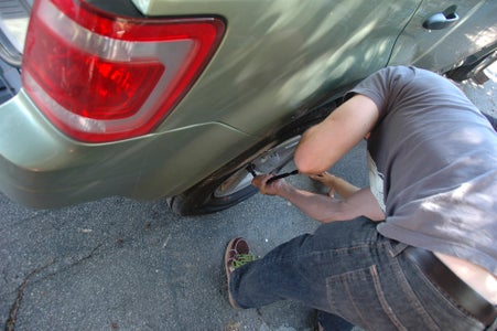

Step 6: Remove the Nuts
They should be loose from Step 3, so your friend should have an easy time unscrewing them the rest of the way.

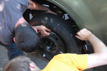

Step 7: Remove the Wheel
Have your friend pull the wheel off of the axle bolts.

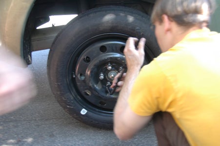

Step 8: Put on the Spare
Have your friend put the spare onto those same axle bolts.
Step 9: Hand-tighten the Nuts
Have your friend tighten the nuts by hand to get the wheel squarely on the axle.
Step 10: Tighten the Nuts
Have your friend tighten the nuts a bit more, so the wheel doesn't fall off.
Step 11: Uncrank the Jack
Have your friend lower the jack.
