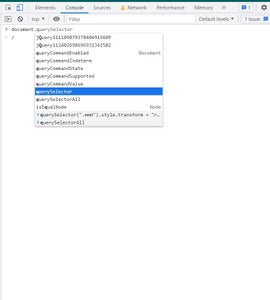

You can get the highlight all the document object methods and properties in the google chrome console by typing document followed by a dot operator just like the above picture.
