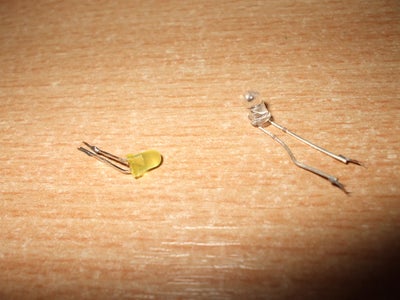

Now you can change the LED's . First get your soldering gun , flip the board , and heat up the solder layer of the LED you want to change . Also press the gun on the board , so the LED will get out of it's connectors when the solder heats up.Also remember where the flat side of the LED was before you removed it ! LED's are polarized , so they need to stay in a certain direction in a circuit . You need to remember where the flat side was to know in what position to put the new LED.
Now , get your new LED and cut it's pins to the same length as the original keyboard LED .
Insert your new LED in the old LED's place and then solder it's pins.Remmeber to put it with the flat side in the correct direction !
