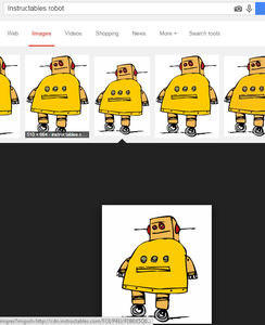

To find the right picture for your chart, you will have to search Google images with the desired picture (e.g. 'instructables robot').
When the page loads you need to look for front on images, you want the pictures with a white outline and not anything else.
Left-click on the desired picture and it should open, right-click on the image and in the drop down box select 'save image as'.

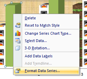

Select a series by clicking on one of the bars, you now can right-click it and open up the option that says: 'format data series'.
From here you need to go to the next step.

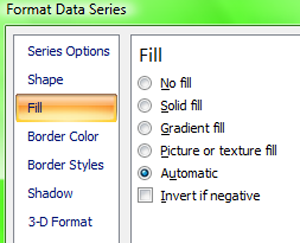

Now we have the formatting box open, select the option on the left-hand pane that says: 'Fill'.
Find the option in the main pane that says: 'Picture or Texture fill', select it.
Still in the main pane there should be an option to 'insert from file', click it and select your desired picture.
Now you need to find the little option that says: 'Stack' it should be in a group of three options, the other two will say: 'stretch' and 'stack and scale width'.
Do this with all the data series and you are done!
