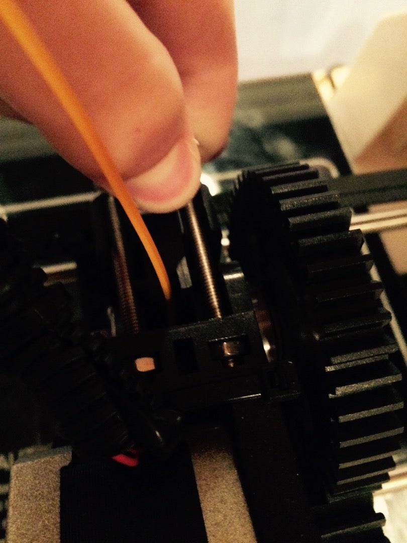

Step 2: Changing the Filament
When doing this do not bump into or move the Y axis and try to stay on the sides of the printer so you don't risk moving it because it is hard to get that back into its position.
Now that you have the extruder in your desired spot, carefully pull the latch back that holds the filament in and remove the filament like you normally would, (if you have a knot in the filament now would be the time to cut it off or untangle it) then re-insert the desired filament that you would like to print with like you normally would, and move the Z axis down until it touches your print (you should only need to press it how many times you counted to move it up to that position.
If you move the X axis it does not matter that much because we will fix that in the next step.

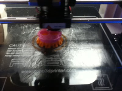

Step 4: Resuming the Print and Some Other Stuff
This step is easy, all you have to do is press the resume button and watch a few layers to make sure that it is printing right and once your satisfied you can leave it alone.

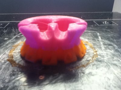

Step 5: Examples
the orange picture is a golf ball holder and if you can see the bump, that is where I stopped when I found out that there was a knot in my filament. that was my first attempt at this trick
My second attempt at this trick was to make a multicolor print, It worked out really really well and it looks like it was made by a dual extruder but it wasn't.
above I made some examples from this method, and I plan to add more images in the future
sorry if they are not the clearest photos
