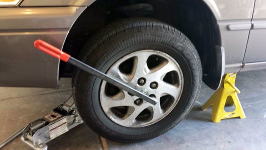

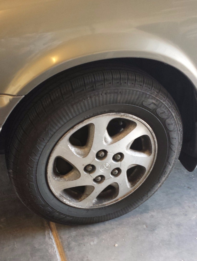

Step 2: Pulling Off the Wheel

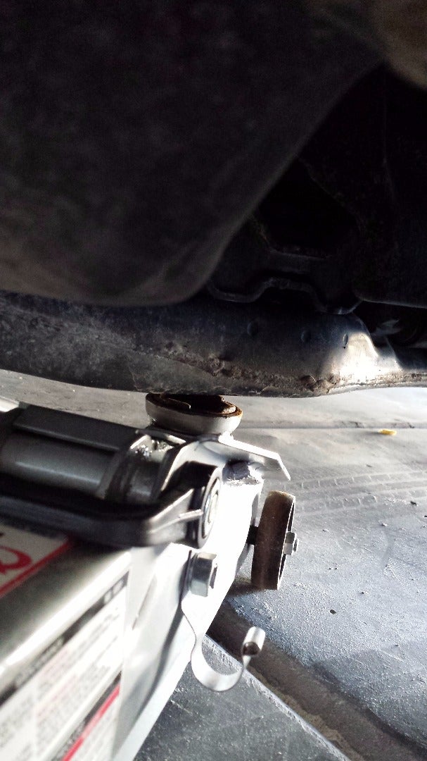

It's always easier and safer to break loose the lug nuts before jacking up the wheel. Don't take them off, just loosen them.
When placing the jack, be sure to place it securely on the frame where it won't slip around when the car is propped up. Then you can finish loosening the lug nuts and remove the wheel.

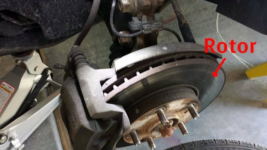

Essentially this is what you're going to see when you get the wheel off. The brake caliper is the big bulky part placed over the rotor (the disk.)

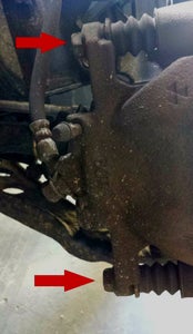

Step 4: Removing the Caliper

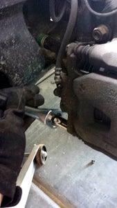

On the back side of the caliper you'll see 2 bolts. Remove them and it should slide right off with a little assistance from a screw driver.
Once the caliper is off, gently suspend it with a wire or other method. DO NOT LET IT HANG FROM THE BRAKE-LINE! Doing so could cause damage to the line and result in loss of functionality to the brakes, which is obviously not a good thing.

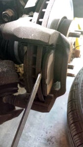

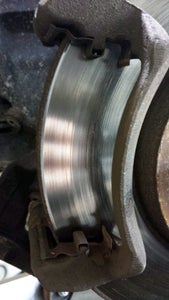

Step 5: Removing Pads & Inspection

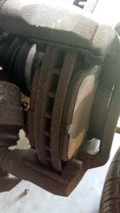

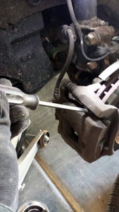

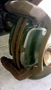

Again, you can use a screwdriver to gently remove the brake pads.
Always inspect the rotors for any wear. In the picture above you can see half of the rotor is smooth/shiny while the other is rough with gouges. If these are deeper than 1mm I recommend getting them resurfaced at a shop for about $10-15 or buying new ones at $20-40 each.
For this situation I didn't bother resurfacing the rotors. It wasn't bad enough for me to worry about. Plus my car is 16 years old so I'm not too concerned about it. Since the change I've put on another 5k miles and there have been no issues.

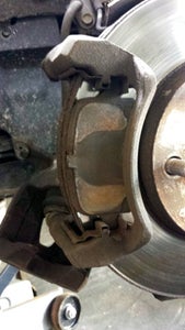

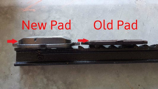

You can also see how much wear the old pads took when compared to the new ones. You never want to wait this long to replace the brake pads! A good time to change them is when there's little more than a quarter's width left on the pad but no later. Many brake pads have a squeaking mechanism built into them to help alert you to their condition, but I've noticed these aren't always reliable. As a matter of fact, I wasn't aware to change these pads until I heard the grinding, which is a sure indication the pad has completely worn out and the rotors are gouging.

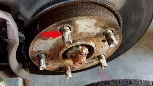

When putting the wheel back on I always like to apply a little aluminum based lubricant to the lug-nut studs. This helps more with older vehicles but is nice to use with any car.

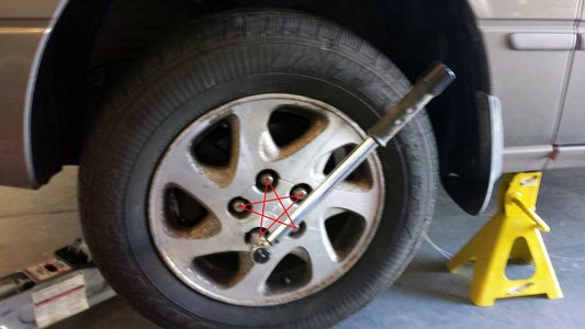

When tightening the lug-nut, use a star-type pattern for evening out the pressure. Don't fully tighten them all at once, just a few lbs at a time, repeating the same pattern until you've reached the proper torque specs.
