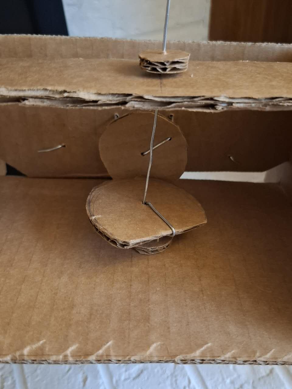

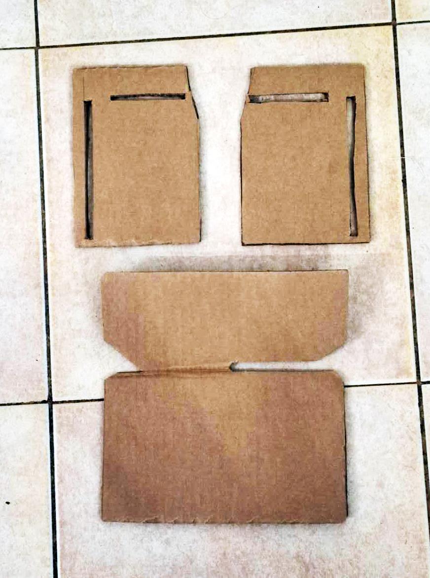

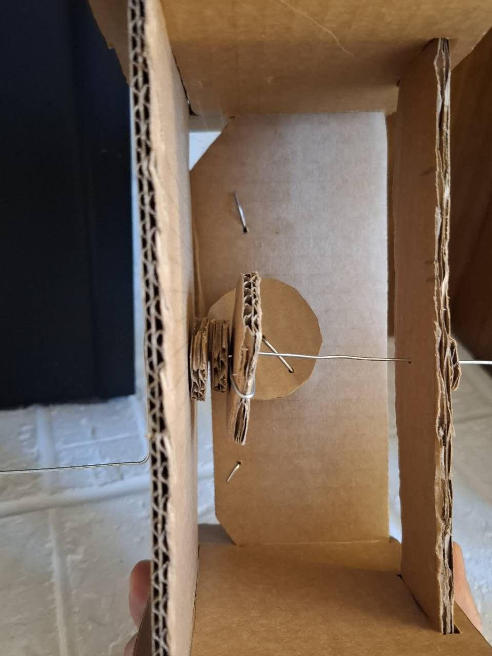

- Cut cardboard into a base and two gears:
- A larger gear with a 90-degree segment removed from its circumference.

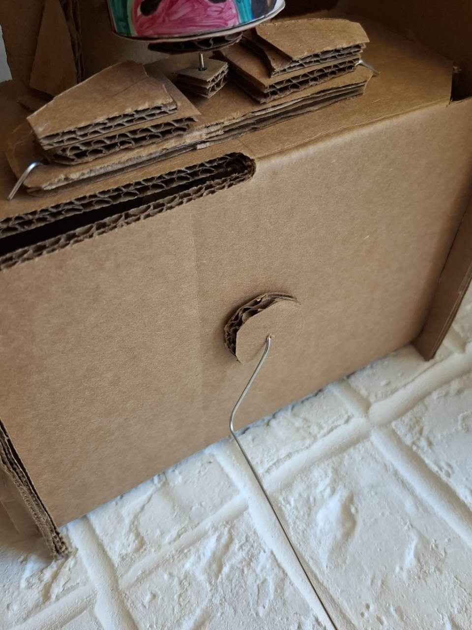

- Use steel wire as axles to connect the gears, bending one end into a hand crank

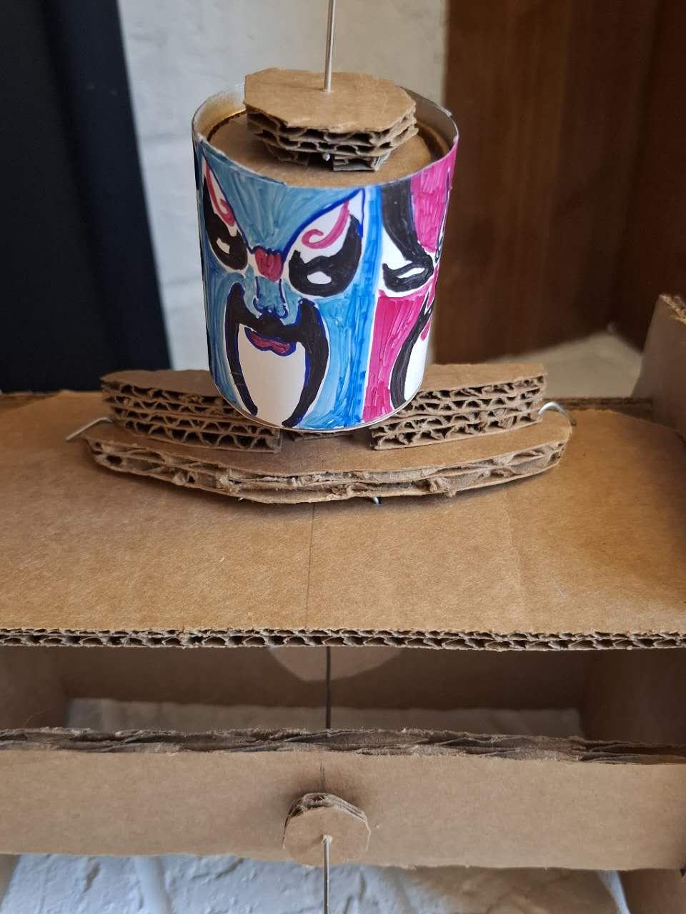

Step 3: Create the Masks
- Wrap the "head" (tea tin) in white cardboard, dividing it into four sections.
- Paint four different opera masks, one per quadrant.

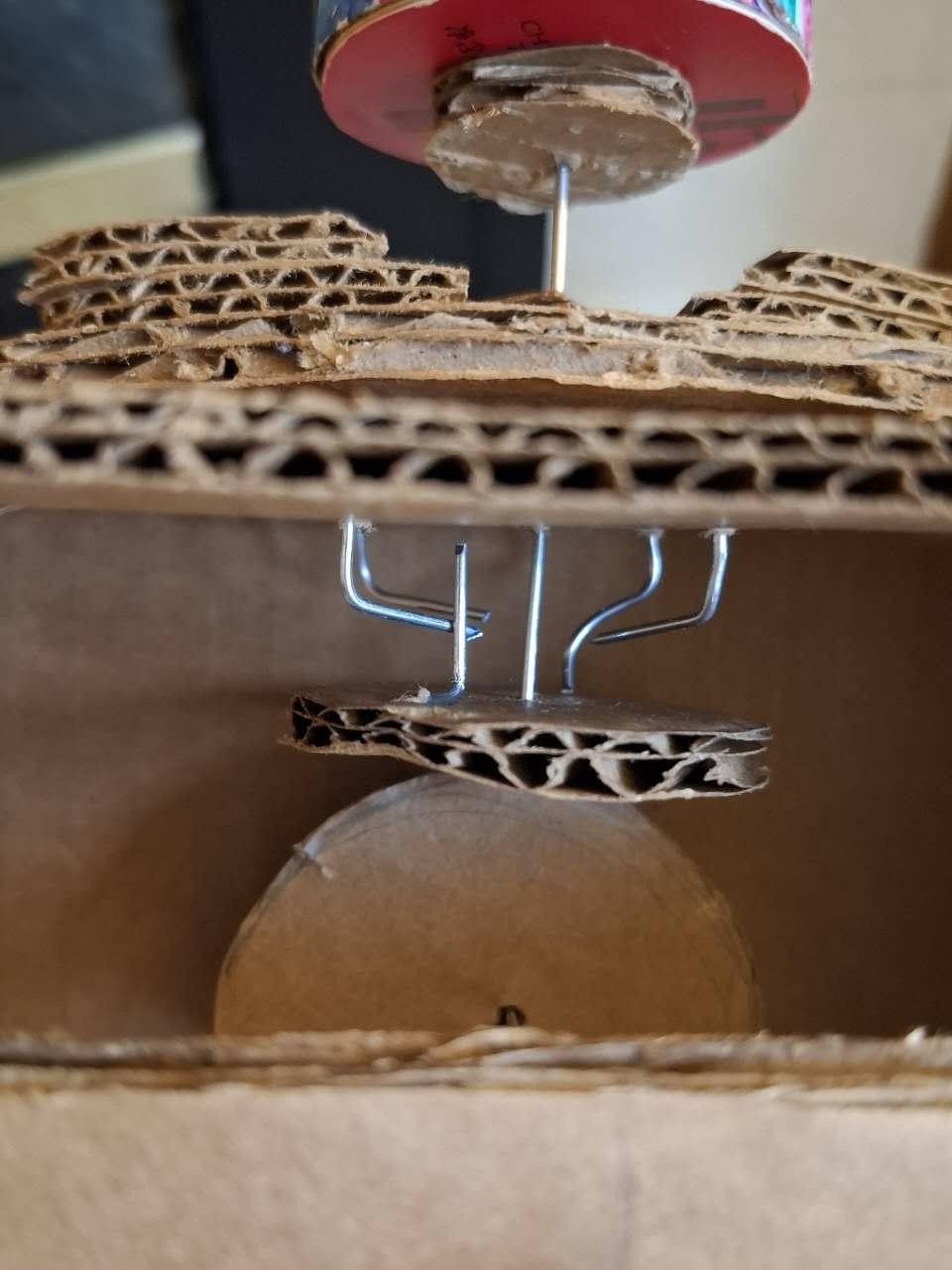

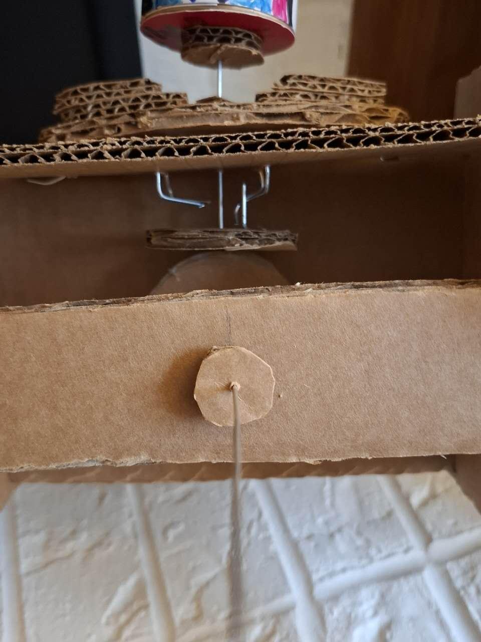

- Add four wire stoppers to ensure the head rotates precisely ¼ turn per crank, dropping into place for each mask.
- Adjust until the head smoothly clears the stoppers when turning.

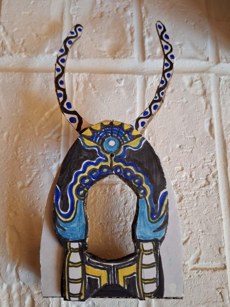

- Attach a front panel with a window aligned to the masks, decorated with a traditional headdress and costume.
