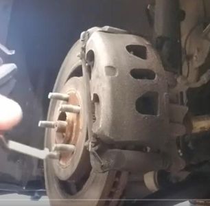

Step 1: Lift Car and Remove Wheel
Support with jack stand

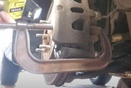

Step 2: Compress Caliper and Remove
Then remove rotor

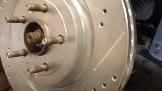

Step 4: New Rotor On
Put rotor on axle and add the locking bolt if it has one
