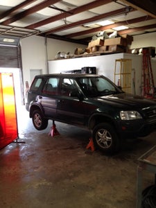

Step 1:
Always use jack stands when working with a lifted vehicle!!!!!
Lift vehicle at lift at specified lift points(see owners manual).

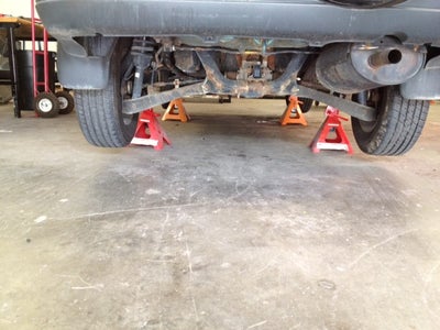

Step 2:
Place jacks under vehicle at specified locations(again,see owners manual).

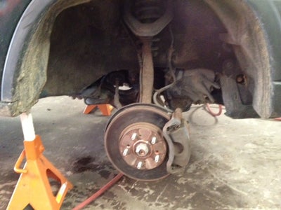

Step 4:
Remove brake caliper. If at any point you find a very tight bolt or nut, spray it with penetrating oil and let sit for a bit.
When you get the caliper loose, do NOT let it hang by the brake line! Support it with a wire or let it rest on the backing plate.

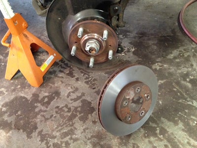

Step 5:
Next remove brake rotor. Loosen and remove screws that hold rotor to the hub. It is best tom use an impact screw driver to do this.
