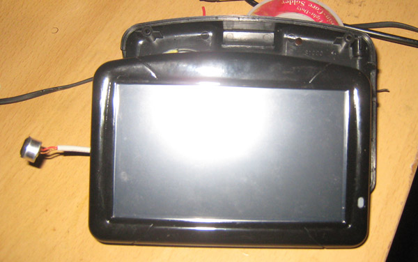

Introduction: Changing the Battery on the Omnitech GPS Device.
When I first received my Omnitech GPS unit, it had already experienced a rough life. Whoever owned it before me had an abusive relationship with it. The SD card it came with was corrupt. There were scuff marks all over it. Worst of all, it exhibited the tell tale signs of charging abuse, a drastically reduced battery life. Add to that, the battery was inflated like a balloon. That is a sign of gas build up which is natural for li-ion batteries. However, the amount of bulge suggested that this cell was at the end of its life cycle. The quality inspectors at the Omnitech factory would have been in tears if he had seen this unit. So now, I set out to show you how I changed the battery.
For this instructable, I'm going to purposely leave out detailed information. The missing information should be obvious for those experienced with electronics. Why am I leaving out information? Because you shouldn't be doing this.

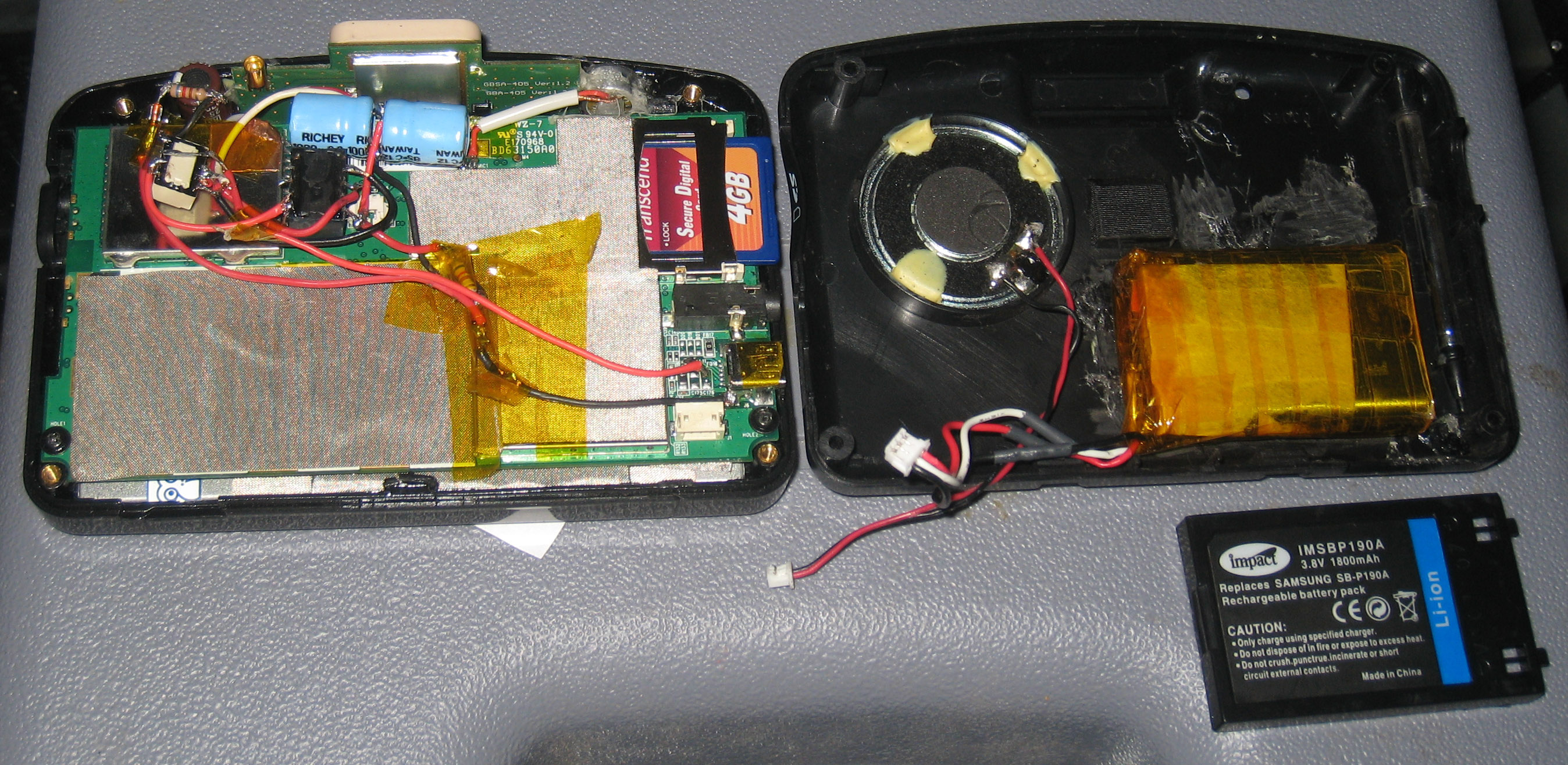

Step 2: Get Your PCB
Your old battery pack consists of the li-ion cell and a protective PCB. Since your Omnitech unit "talks" to that particular PCB for charging, you will need to harvest it from your old pack. Do this carefully, because if you break it/fry it, you will no longer have a battery. Use a voltmeter to keep track of the polarity of the contacts. The PCB is attached to the li-ion cell with metal strips. When cutting the metal strips make sure to leave an extra amount on the PCB side. This makes attaching the PCB to the new cell a lot easier. Don't forget to keep the thermal switch on the portion of the metal strips that is attached to the PCB. It will be on the positive lead. You will need that for your new pack.
Remember, no Omnitech PCB means no battery pack. I tried looking up a replacement, but the PCB has no markings. The few PCB's that I did try on this unit failed to initiate charging.

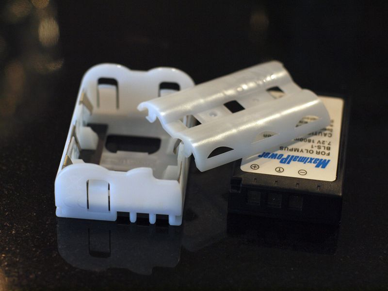

Step 3: Prep Your New Cell
I used a generic camcorder battery I bought for $5 for my new cell. Before that, I tried a Nokia bl-5c, and that gave me about 45 mins of battery life. It is up to you to find the new cell. Because of the low power requirements of the Omnitech, you can use almost any li-ion cell of the correct voltage.
You will need to strip the PCB off of your new battery. Use the same cautious approach you used when dismantling your original battery pack. Make sure the new cell retains a good amount of the metal strips. This will allow you to avoid soldering directly to the cell itself later. Verify the positive and negative terminals using a voltmeter. Do not assume the polarity is the same as your old battery just because they look the same. Throw away the PCB and thermal switch of the new cell and continue.

My new cell was a few mm too large for my case. So I used a dremel to dig out a space for it in the back cover. Even though the new cell was advertised as 1800 mAh on the outer case, the cell itself had 1400 mAh printed on it. Expect the same from any $5 battery. In the end, I had over three and a half hours of battery life. That is a good improvement on my original 30 min battery. Below, I have my final unit with all three instructable mods on it.
