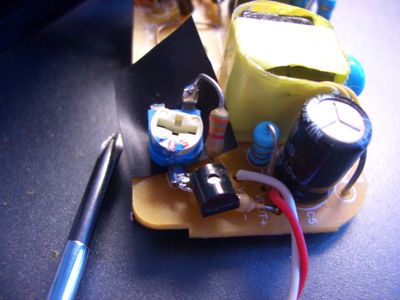

Step 2: Calculating New Parts and Modifying the Device
I wanted to keep the sum of R10 and R14 about the same as it was in the original circuit. That is round about 10kOhm. To get a higher output value I needed to modify the resistors according to the data sheet. I also needed to replace the protecting zener diode.
For the protective zener I choosed a 10V type because I found it in my parts collection. This voltage protects the output capacitor.
Calculating the new resistor values I started with R10 using the formula of the TL431 data sheet and kept the 10kOhm in mind. The calculated resistor would be 6.5kOhm. That is not a resistor value that is common. I selected a near value of 6.8kOhm.
Now I calculated the value of R14 using the choosen value for R10. The calculation leads to a value of 3.777kOhm for R14. I choosed a value of 3.3kOhm and added a 500Ohm trimmer potentiometer.
Because of the tolerance of the circuits it seems to be a good idea to insert a trimmer to adjust the output voltage.
After removing the original parts from the soldering side of the pcb I added the new parts on the components side because I did not use smd parts.

The voltage meter shows exactly 7V (ok .. it's 7.02V). That's what I wanted :-)
