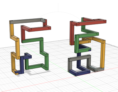

This is a concept I explored years ago doing bent wire sculptures with students. For several years I have thought about making a piece of furniture based on this concept, but struggled to imagine how to plan it out and conceptualize it on paper. It wasn't until I began incorporating CAD into my woodworking planning process that I had the skills to plan this project.
I used Autodesk's Fusion to plan out the path of the base, to plan the orientation of each lap joint, and then referenced the file directly as I built. 3D modeling was essential in designing and creating this project. A viewable, interactive copy of the model can be accessed here even if you don't currently use Fusion.

Step 3: Sub Assemblies
Cut and Assemble
Working one piece at a time, use the 3D model to choose the correct length and to mark where to cut the lap joints. Each sub assembly is represented by a different color in the model.
