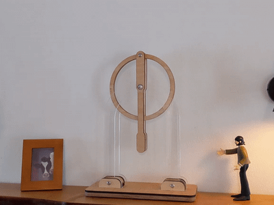

I have always loved chaotic pendulums. I've seen many types of them. Some have 2 moving parts, some have 3, even more are possible.
I saw a version on YouTube that I liked very much. It like all others I've seen are one sided, offset from a wall or stand. I wanted to make one that was supported from both sides, to make it symmetrical and freestanding. A version that works as a sculpture even when static.
I designed this using Rhino. I've included the model in STEP format which can be imported into other CAD programs, should you desire to customize the design. Visual changes can be made as long as the sizes (and therefore weights) remain close to the same.

Step 1: Cut and or Fabricate All Parts
These parts can be made from nearly anything you choose. And they can be cut using any method that works. But I designed this with laser cutting and/or CNC in mind. I used a vendor to cut the parts, sendcutsend.com. They used laser cutting for the 1/4" thick parts and CNC for the 1/2" parts. That is why they look different in the photos. I liked the mix of clean machined edges and laser cut burned edges.
The wood parts are birch plywood. The plastic is clear acrylic, approximately .25" thick (sendcutsend.com offers .214).
Cutting the parts by hand with power tools is possible, but the holes would need to be drilled very precisely.
Included are drawings for all parts, in DXF and PDF formats.

Step 6: Final Assembly
Assemble all of the parts. There is no particular order this needs to be done it. It may take a few attempts.
Step 7: Try It Out and Adjust Weight As Required
Try it out. Experience the chaos.
You may have an amount of weight in the end of the arm that works well on the first try. If not, just remove the weight holder and adjust. If the weights are loose, you'll have a kinetic rattle. If you would like it quiet, just put some caulking in with the weights.
