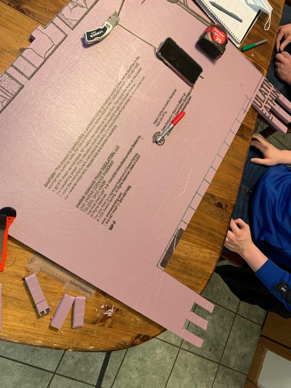

Step 1: Cutting the Base of the Hallway

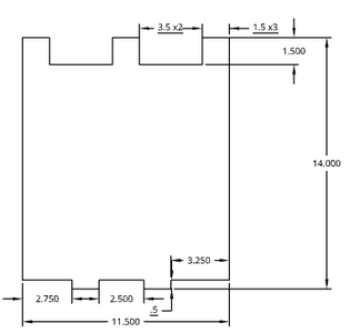

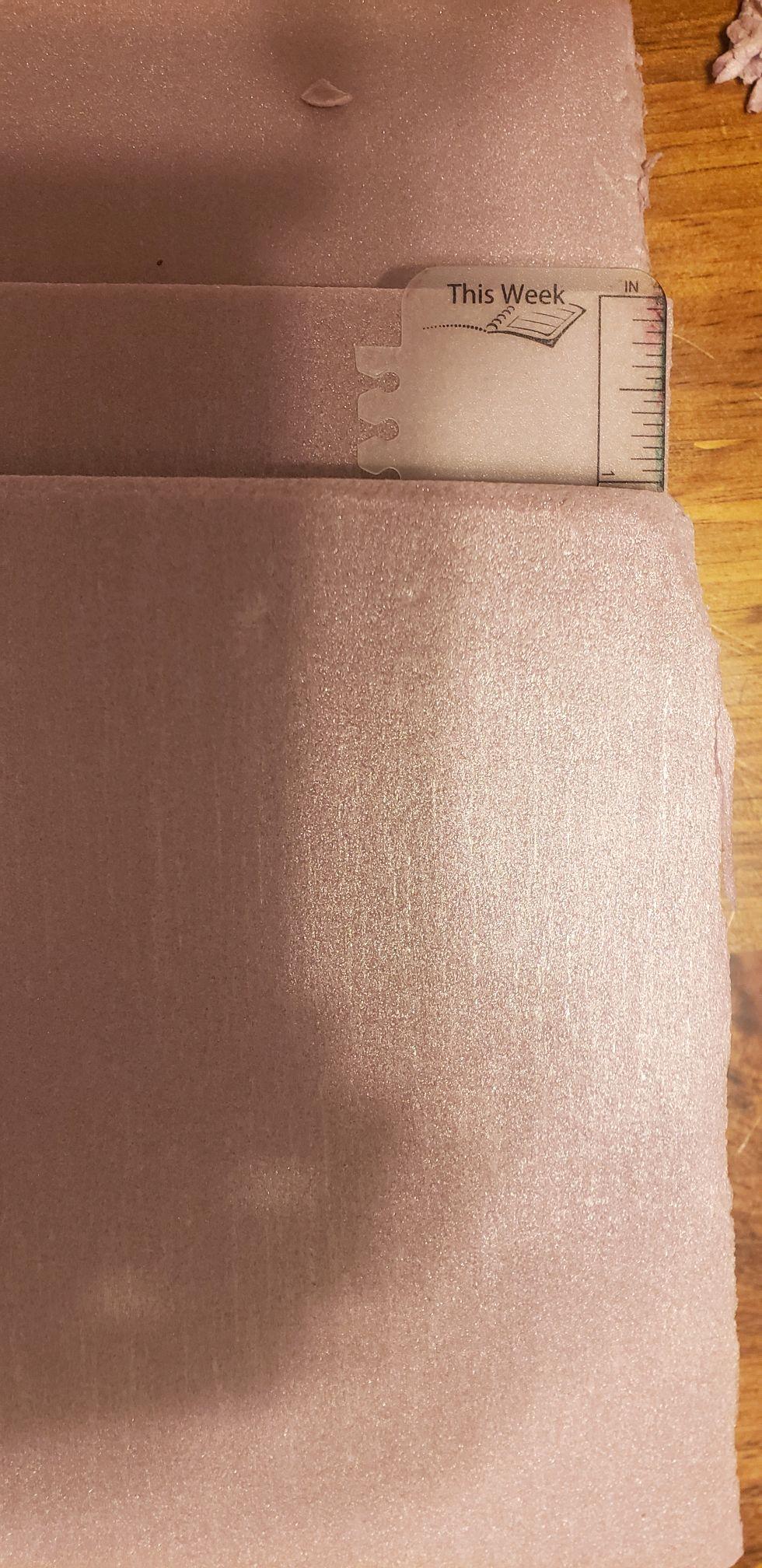

Using the mechanical drawing above, mark and cut out the given dimensions for the base out of the foamboard. A good tip here is to use some sort of large straight edge for marking and cutting to get a cleaner looking set piece.

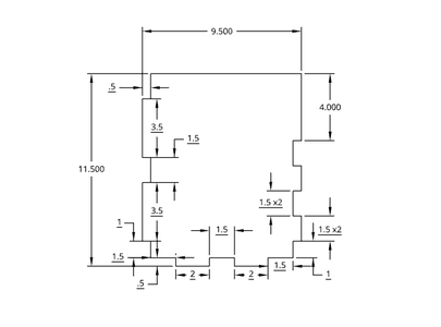

Step 2: Cutting the Rear Hallway Wall

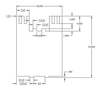

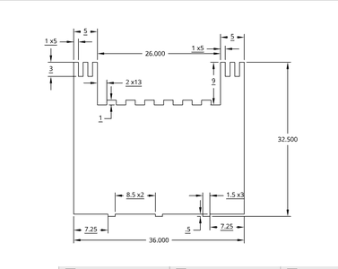

Using the mechanical drawings above, do the same thing as with the base. Mark and cut out the given dimensions. Another tip here for the rampart walls is to leave extra material and mark off what needs cut and what doesn’t. Use the other picture as an example.

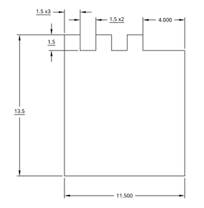

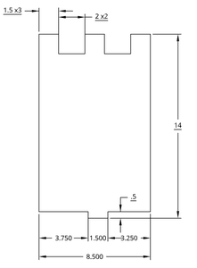

Now we will move onto the balcony that is found within the hallway assembly. By this point you should have a pretty clear idea on how to accurately mark up and cut out the pieces of the assembly. These pieces will be smaller so should hopefully take less time! Similar to before use the technical print above to mark up and cut out this piece.

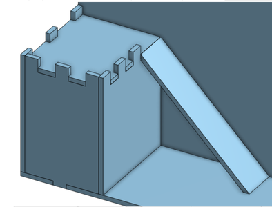

Step 6: Cut Out Balcony Base/Floor
Similar to the previous step, use the technical print above to mark up and cut out this piece. BE CAREFUL, this part is particularly complex so pay close attention to detail. For reference, see the attached CAD image to better understand how this part is made.
Step 7: Assemble and Fasten Together the Hallway

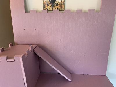

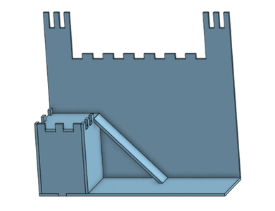

Mating the male ends of the cut out foam boards to the female ends, force fit each piece together to look similar to the assembly shown above. The back wall can only fit on one side of the base so it should be easy to assemble. Use glue or tape to secure each piece in place if necessary.
Step 8: Create and Fasten on the Ramp

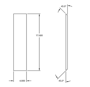

It is time to create the last part of the hallway assembly! Using the mechanical drawing above, mark and cut the rectangular ramp. The 45 degree angle on each end is completely optional and only for making the piece fit more nicely into the assembly. Use either glue or tape to fasten the ramp into place as shown by the CAD image in the previous step.

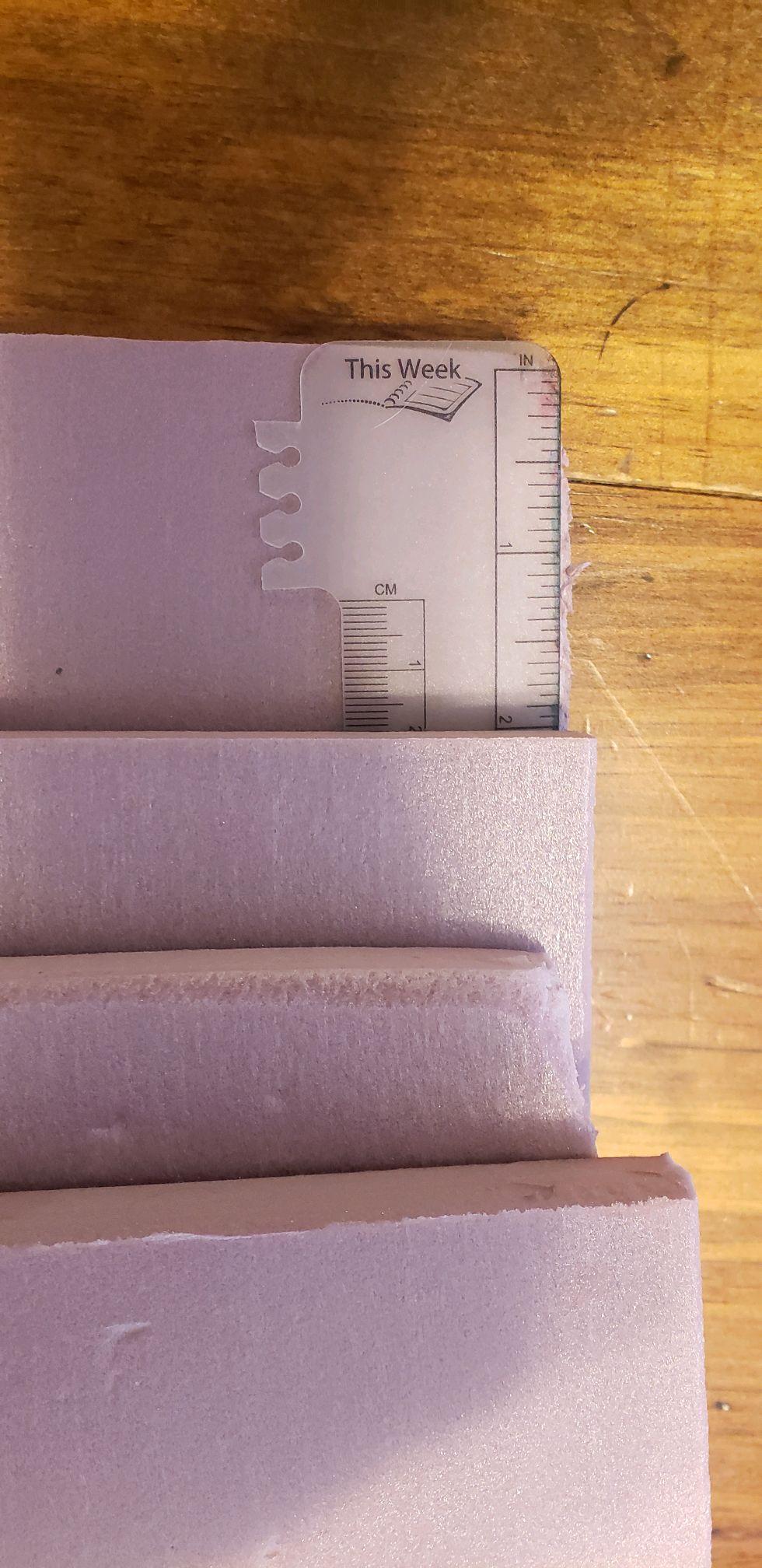

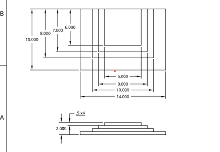

Step 11: Cut Out the Throne Steps
Pay Attention to spacing left! This part is four rectangles put together to form one part. Use the mechanical drawing above for the appropriate dimensions and use the following image as reference to how to dimension and mark up your part before cutting.
Step 12: Assemble and Fasten the Throne Steps
Once all of the steps are cut out, align the steps into place making sure there is 2" on either side for the first piece, and 1" for the others and mark where the ends meet. (See images/schematic above for reference) Place glue underneath each of the smaller steps and place along the markings you just created.

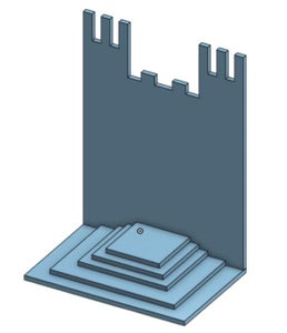

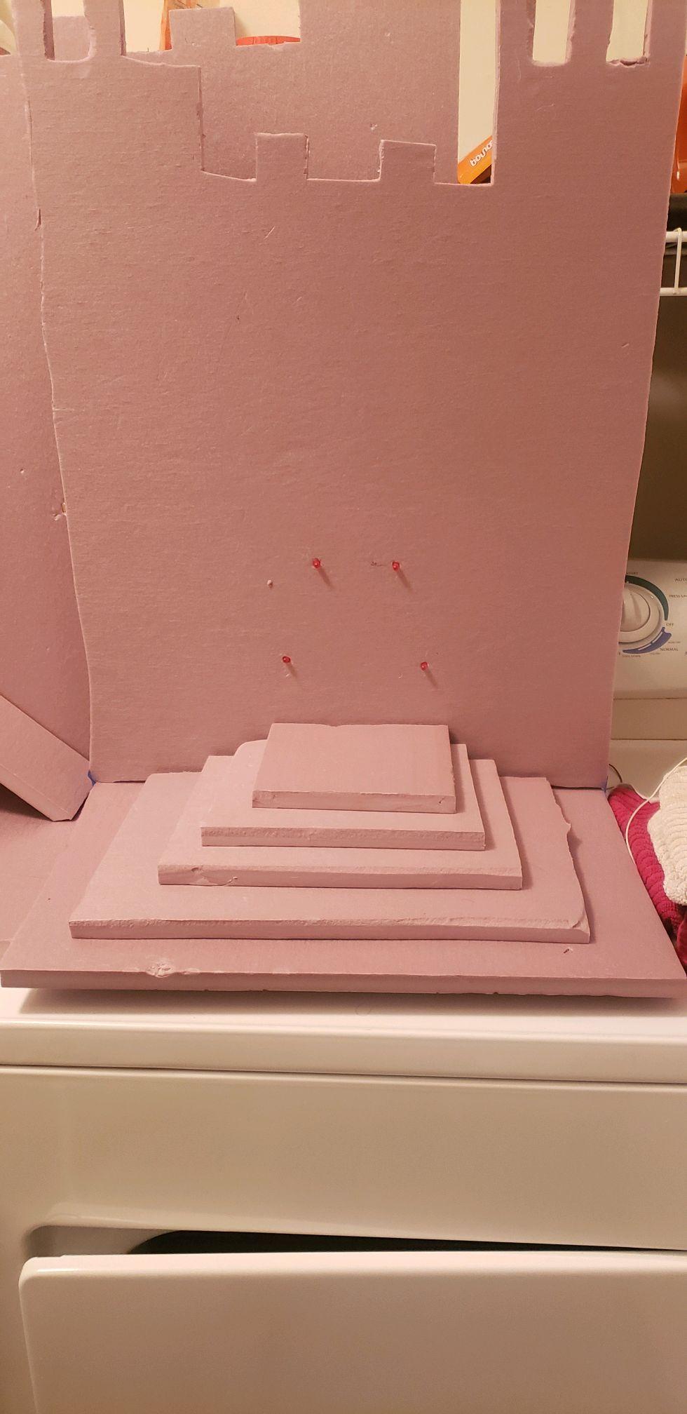

Step 13: Fasten the Throne Assembly Together
Align the newly conjoined stair case towards the center of the base making sure to leave a 1/2" of room for the rear throne wall. Once aligned glue the stairs and base into place. Add several tape loops along the back of the stairs and aligned the base and read wall with the groves, press the wall into the tape loops.

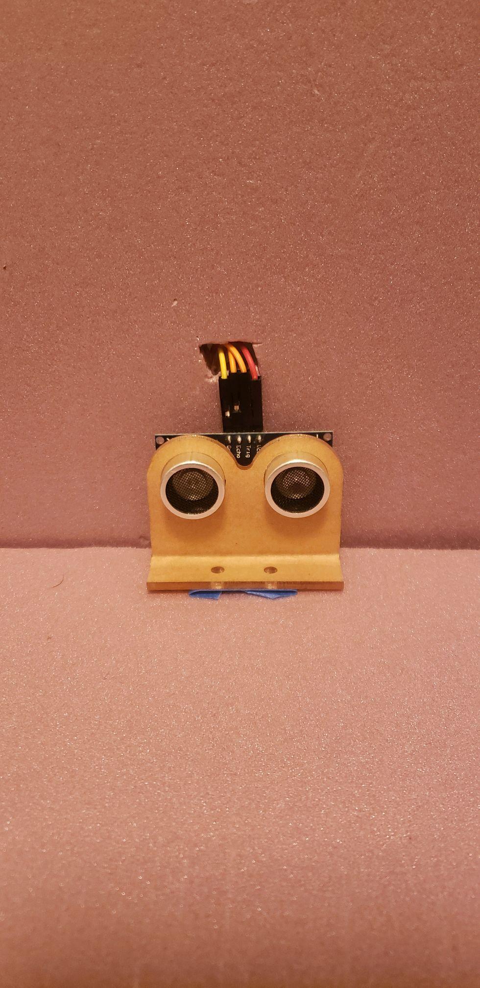

The first step in terms of the physical software control is a tough one. Flip the sonar around so that so that the pins face upward away from the bracket. Tough stuff :)

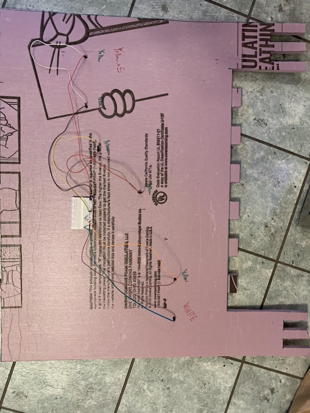

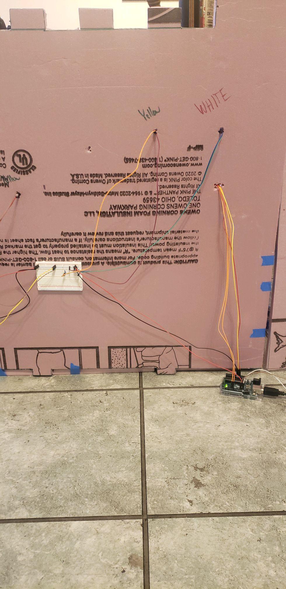

Step 17: Wire the Hallway Assembly

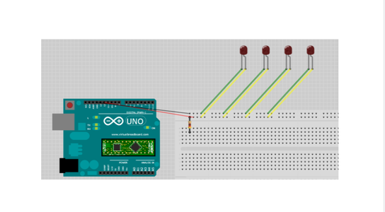

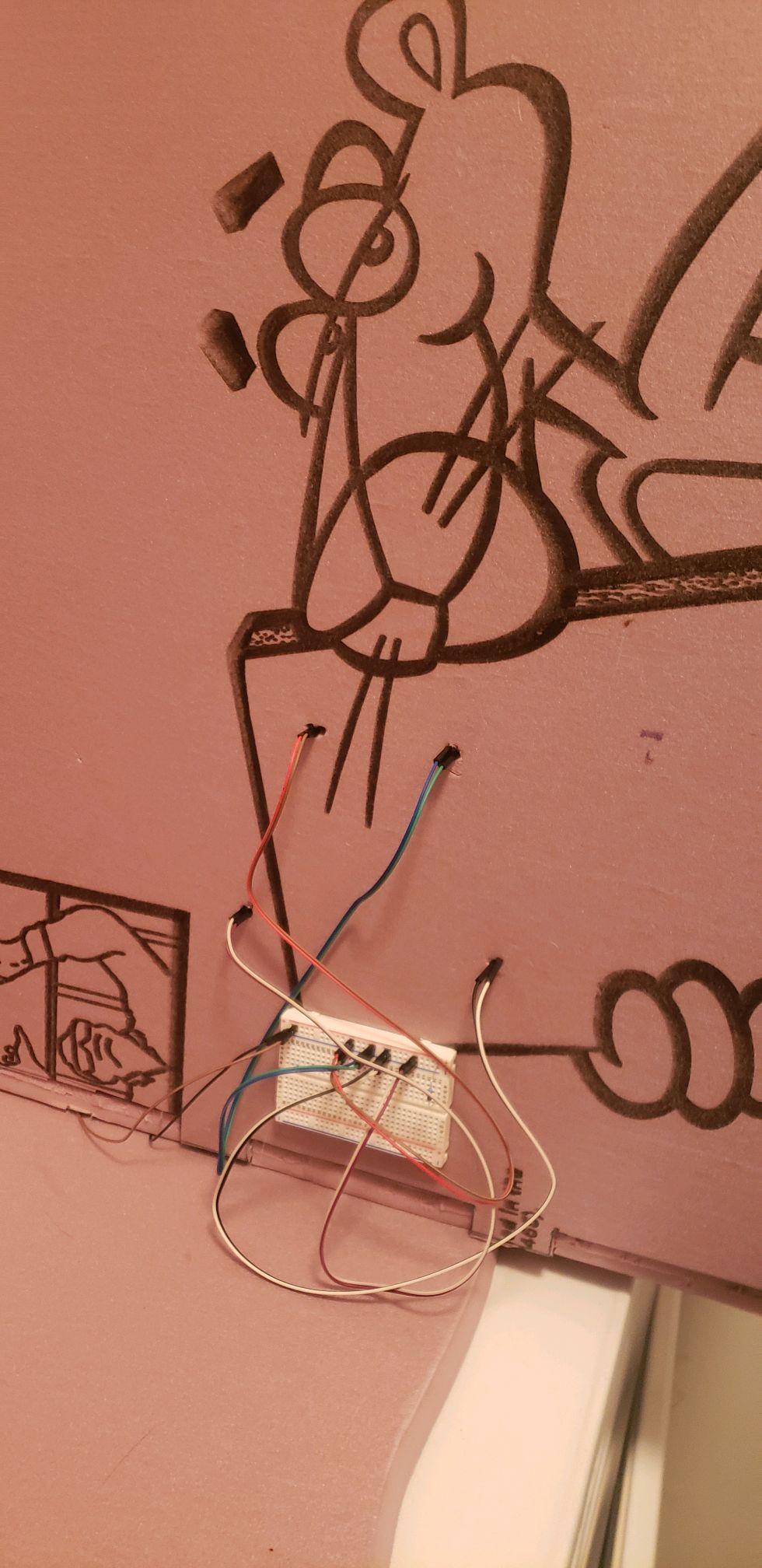

Using both the schematic and image above, wire the diodes to the breadboard. Make sure to closely follow which wire goes to which lead, the longer lead of the two is for positive (input voltage) and the shorter negative (output voltage). When wiring make sure to include the 220 ohm resistor, as without you may risk burning out the diodes as they cannot handle voltages over 3.2V. Once everything is wired to the breadboard, peel the tape from the back and place it in the center backside of the hallway wall. (The positive comes from pin 13 on the Arduino)
To test if the diodes work, connect the positive bridge of the breadboard with the 5V pin on the Arduino Uno, and run the negative bridge to GND (Ground) on the Arduino Uno.

Following the same concept as the before, we will now wire the throne assembly. Following the schematic and image provided, wire the LED to the breadboard. A 220 ohm resistor is placed after the digital output from the Arduino is ran to the breadboard. This is to regulate the current being applied to the LEDs. The positive wire coming from the breadboard should be attached to the longer LED lead. The shorter lead should then run back to ground. (The positive comes from pin 12 on the Arduino)

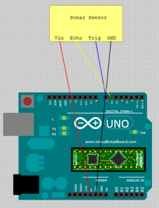

Step 20: Wiring the Sonar Sensor
The sonar sensor has 4 connections. One for 5V power, one for ground, one for trigger, and one for echo. Coming straight from the Arduino, we will want to connect the 5 V to the sensor using a Male to Female jumper wire. The ground will go straight to ground on Arduino. The echo pin of the sensor needs to connect to pin, digital pin 6. The trigger will then need to be connected to digital pin 7.

Using a tape ring on the the bottom of the bracket, install the bracket by placing it along the back of the back of the balcony facing outward. Once the Sonar is placed, cut a slot above it to allow the leads to be wired to the breadboards placed along the back. See image above for reference.

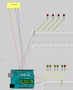

Step 22: Finalize the Wiring
Following the schematic and attached image above, connect all three circuits. Make sure the code is uploaded to the Arduino and test to see if everything works!
Step 23: Completion!
The attacking raiders, immitted only by torch light, should run up the balcony in which they will trip the sonar sensor, giving the king a dramatic reveal! (The black water bottle is the raiders in this example)
